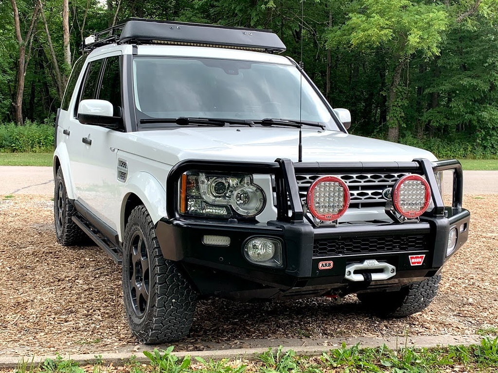

So the ARB Bar you have is the older style deluxe bar. Great piece of kit.
FYI, ARB also sells a new design Summit bar. They say that it only works on the 2014+ models, but that is false. It works on 2010-2013 just as easily. I have the summit bar on my 2013. It has some improvements. Much larger bar diameter, LED turn signals, etc. I just ordered mine at an ARB dealer and they shipped it from Australia. I don't think ARB bars are super rare, but they aren't common either. They are expensive compared to all the options in the states that some dude with a welder just slapped together, engineering be damned.
You must be registered for see images attach

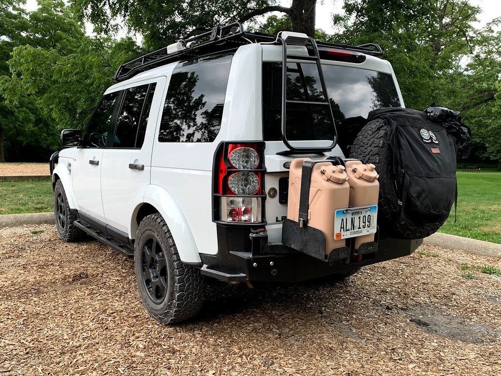

Also, a few other things to check. First, make sure they installed the ARB bumper correctly. You do want spacing between the bumper and the body/headlights, but it looks like it might be adjusted too low. Lots of times people don't drill the "pin bolts" when they install ARB bumpers. The main bolts are in adjustable slots, and then the bumper has holes that go against the mount. You have to adjust the bumper first, tighten the adjustable slot bolts, then drill the pin bolts. That usually requires marking the hole location and then pulling the bumper back off to drill them... people are lazy.
Also.. if you intend to off road, look at sliders, those steps will not do well. Get something to protect the air compressor. Also keep in mind that you tend to pull off the rear bumper cover pretty easily and the rear exhaust is run under the rear suspension. Watch the weight, but skid appropriately.

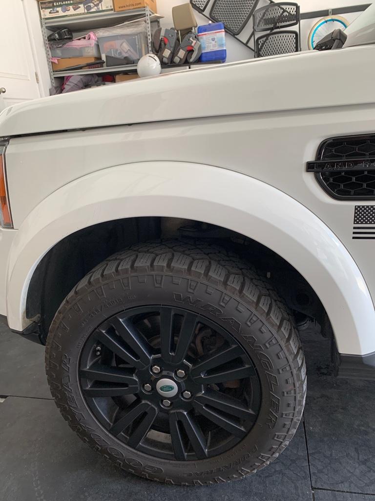

My 2011 LR4 came with the 7 spoke with 19’s in matte silver — and I chose to powdercoat them in piano-key-gloss-black BEFORE realizing that the options were limited in the 19” wheel configuration.
After having spent the dollars on powdercoating, I decided to stay with the 19’s and went with the standard tire size of 255/55/r19 in the Goodyear Wrangler Duratracs and have never looked back or regretted the decision.
They’ve done everything I’ve ever asked them to, and they look great and beefy without being *******... and give just the perfect amount of road-noise, in my opinion!
