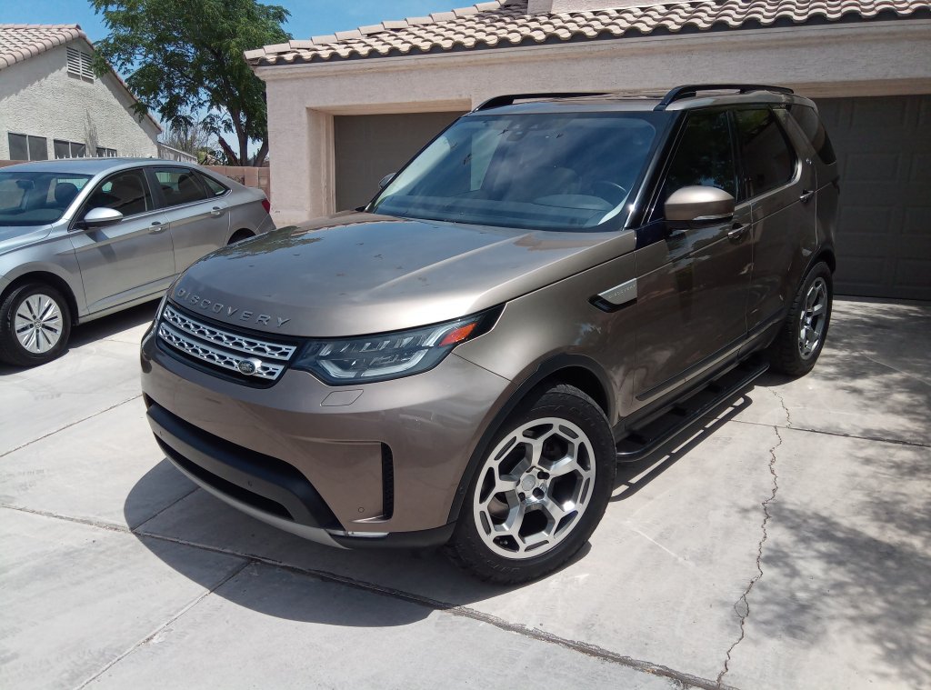

In case anyone's interested, here's a shot of my D5 with 285/50-20 Nitto Terra Grappler G2s on 20" x 9.5" Redbourne wheels (stock wheels were 20" x 8.5"). No lift, no spacers, and no clearance problems.
ar007, I had to ask, was there any back space difference and if any by how much switching from the 8.5" rim to a 9.5" rim? If the 9.5" back space is the same as the 8.5" rim then there is no issues plus you gained having a wider track stance overall times two (each wheel). If the added 1" rim width was split now having a 1/2" more positive (inboard) with the other 1/2" now a wider (outboard) stance vs rim to body.......~~=o&o>........
Not sure what the back space is on the stock rims (I suppose I could go out and measure since all 5 stock wheels with tires still mounted are stacked in my garage) but the Redbourne wheel back spacing is 6.5." redbournewheels.com makes aftermarket wheels exclusively for Land Rover vehicles and their fitment guide and wheel configurator allow you to see which wheels fit and what they will look like on your vehicle (including your vehicle paint color).
