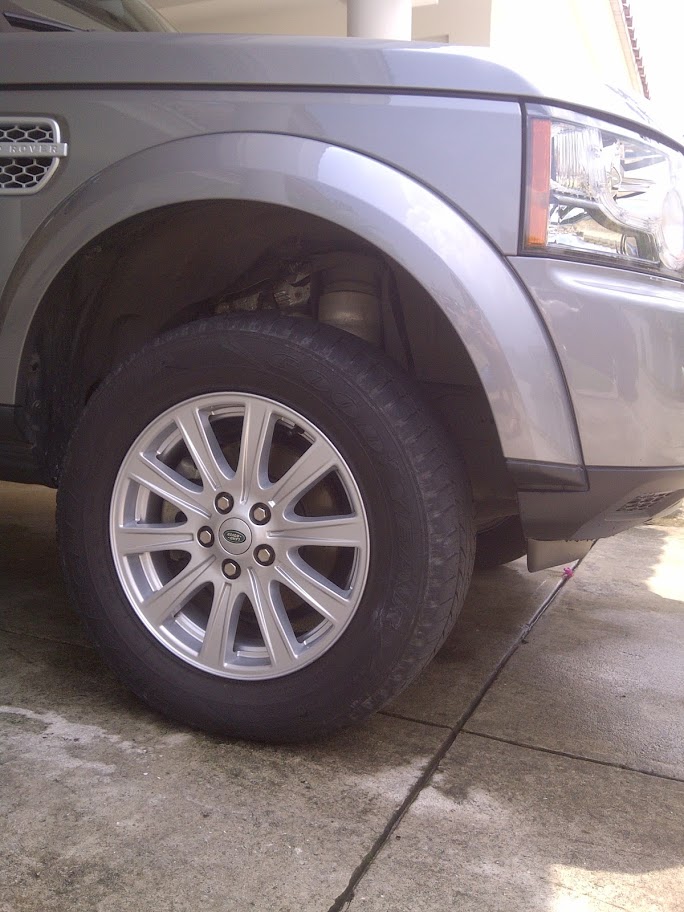

Front wheels are really easy because if you turn the wheel the opposite direction of the wheel you will work on, access is really good. This the front at off-road height:

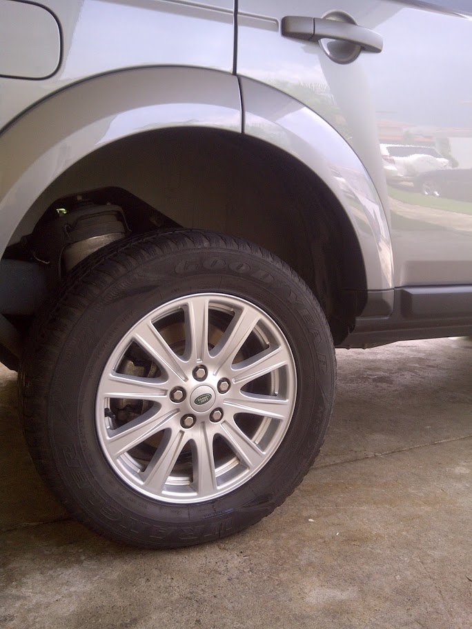

Rear wheels are a bit harder because you have to get under the car and access isn't that easy. Just lift it to off-road height before you get under. Watchout: When you remove the OEM rod the sensor will drop and the suspension will lower :eek:). This i sthe rear at off road height:

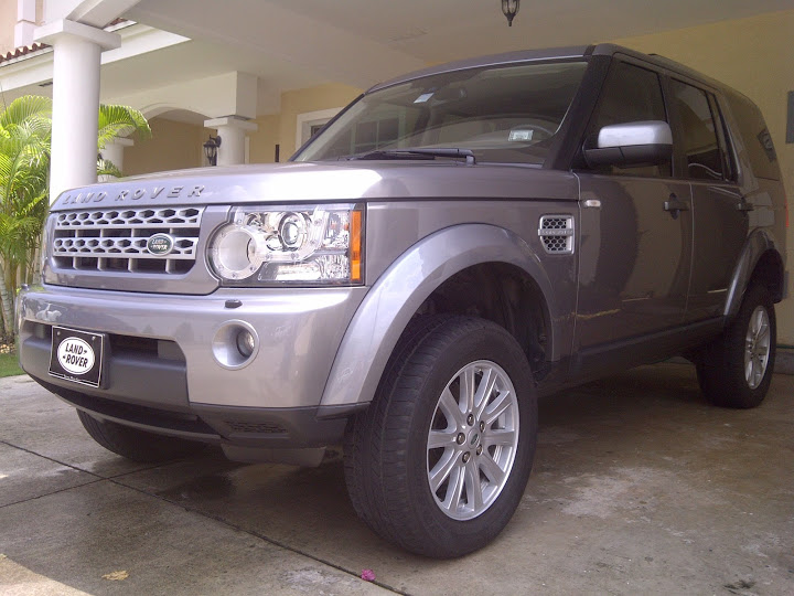

And here are some pics of the truck raised at off-road height:

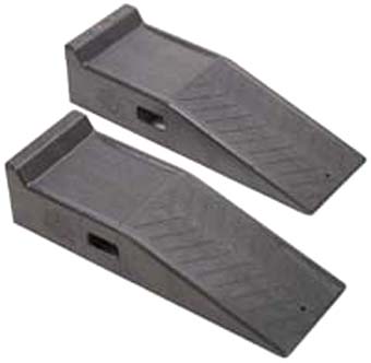

Regarding installation of the rear Johnson rods and the suspension dropping, it might be a good idea to pick up a pair of plastic ramps at the local FLAPS and drive the the rear wheels on top before messing with the rods. I have a pair like these, and they hold the weight of the LR4 fine. Also good for oil changes, etc. — any time you're working under the car but don't need to take the wheels off.
