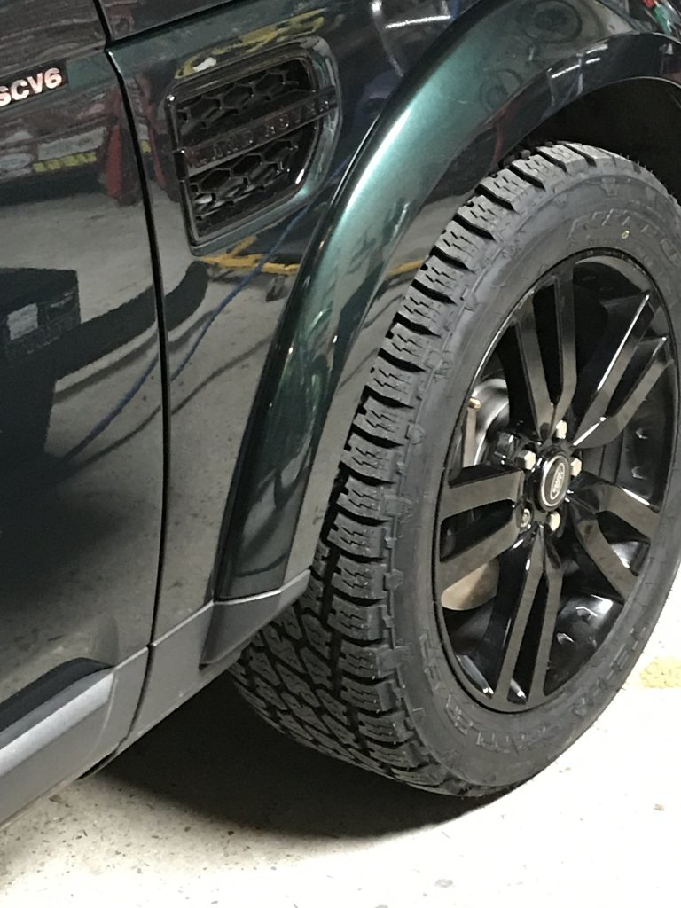

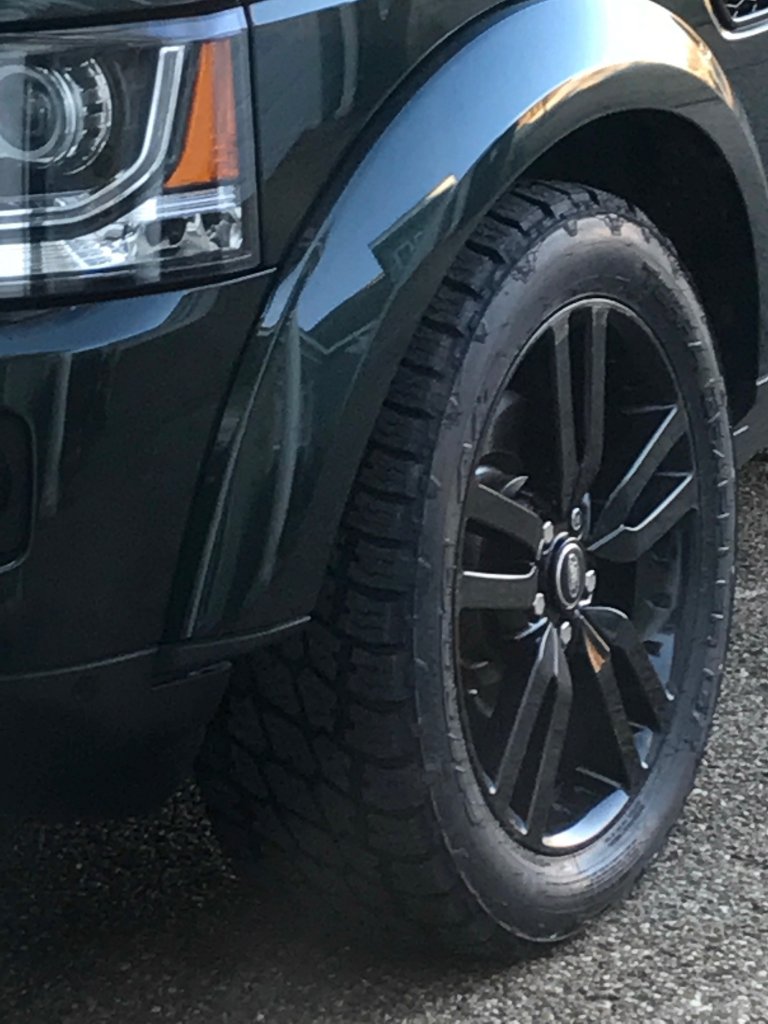

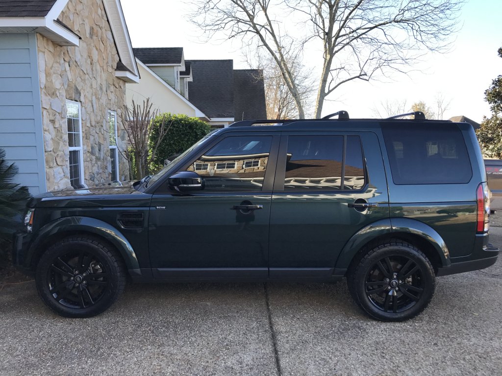

    AL
    Here are some pics of 265/50/20 G2s at standard ride height. 20C82A3A-532C-4345-9EAA-E4DF1FE4B8FC.jpeg 2889F04A-B2F1-4604-BC86-94B7E16865AD.jpeg EBAB7C56-B9F6-4347-8C9A-61A929A033F6.jpeg

    Jomcool - looks really nice!

    Looks good! I love the green on black color combo.

    I really wanted 285s as they look awesome and create some good wheel saving bulge on the sidewalls. I just couldn’t get passed the rubbing issue and spare tire fit issue. I’ve heard that someone ran some 5mm spacers(not sure it’s a good idea) to eliminate the rub but there’s still not an easy solution on the spare other than lowering air pressure, overriding TPMS alert at startup or ignoring, or ultimately relocating the spare.
