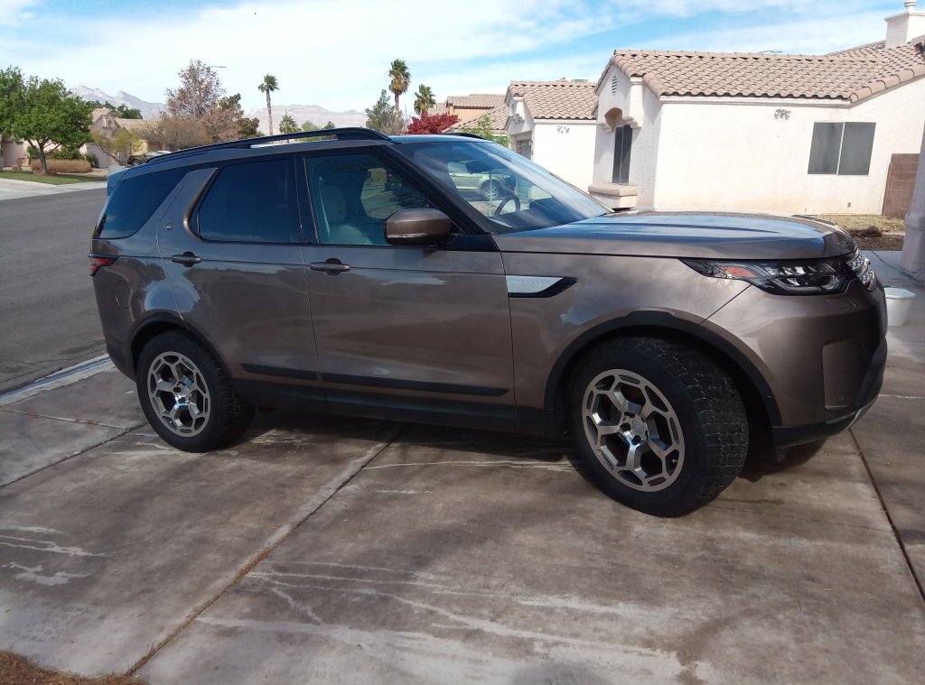

    What you meant to say is that Discount Tire store [viz., the one you went to] will not install tires with any specs below factory. My Discount Tire store didn't bat an eye when installing S-rated 285/50-20 Nitto Terra Grappler G2s in place of the stock W-rated 255/55-20 Goodyear Eagles on my D5 (I also replaced the stock 20" x 8.5" wheels with 20" x 9.5" Redbourne wheels). Find another Discount Tire store.
