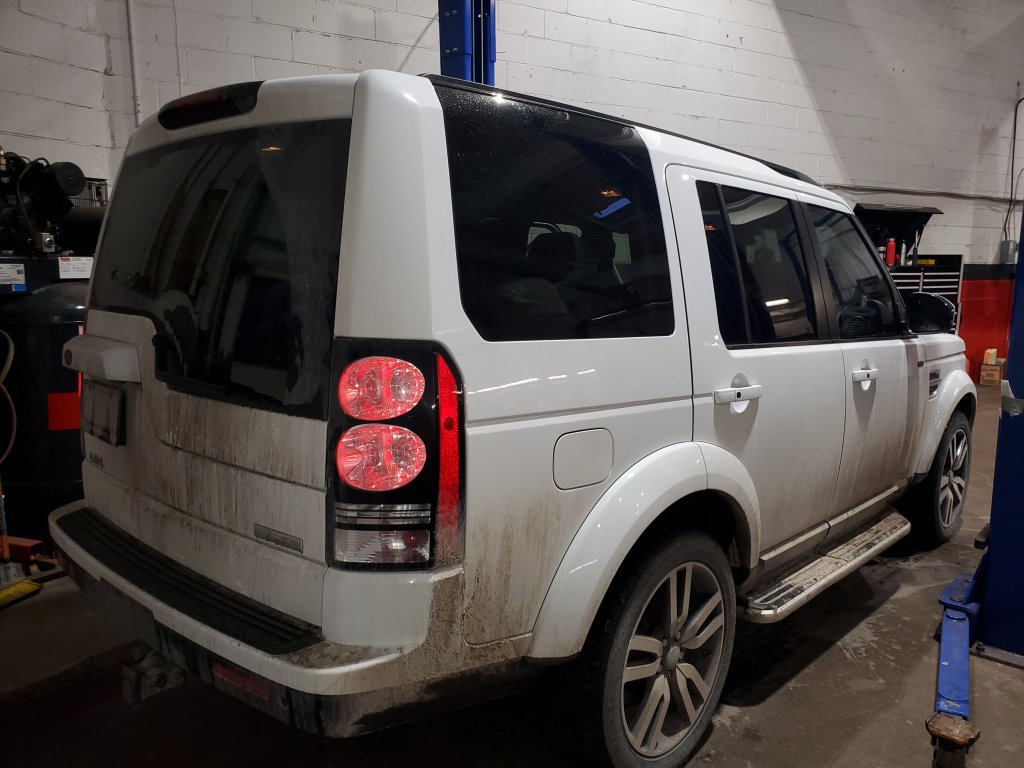

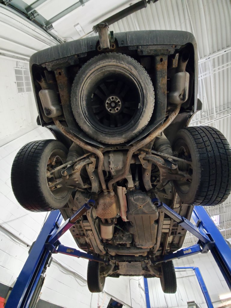

I've been looking to purchase a LR4 for years. I live in Canada, and finally found a 2016 LUX with HD package. Approx 65k miles. It's been very well maintained and taken care of, however I had a PBI done today. The shop recommends a passenger side valve cover seal replacement (very mild leak), a new water pump assembly, a new vacuum pump (mild leak), and an updated factory maintenance service (oil change, transfer gearbox fluid change, rear diff fluid change, brake fluid change). The current owner is willing to take care of all of this before the sale. However, my biggest concern is the rattle that is apparent at cold start up. I have attached video. Indy JLR shop thinks either supercharger isolator, water pump (which is going to be changed anyway), or timing chains, but they will need to investigate to determine cause ($149 CND/hr). Any thoughts based on the video? I really would like to purchase this vehicle as a 2016 LUX with HD is an extreme rarity up here, and I really need a new vehicle (I know, the worst time to buy used). Any insights would be greatly appreciated. Thank you!

Thank you for all of the replies. The shop disconnected the supercharger and noise persisted (although slightly less). Slight noise from water pump pulley, but noise persisted. Diagnosed timing chain as the issue. I have several videos of all of the above, for anyone who is interested. The shop is a very highly respected JLR indy shop in Toronto. Here is what was written: "DURING OUR DIAGNOSIS WE FIRST REMOVED THE SUPERCHARGER DRIVE BELT AND INSPECTED THE SUPERCHARGER ISOLATOR WEAR. WE FOUND THAT IT IS SLIGHTLY WORN AND THERE IS SOME PLAY THAT MAY BE CONTRIBUTING TO THE ENGINE NOISE. ATER STARTING THE VEHICLE WITH THE SUPERCHARGER BELT REMOVED THE MAIN ENGINE NOISE WAS STILL PRESENT. WE PROCEEDED TO REMOVE THE MAIN DRIVE BELT ELIMINATING ANY OF THE DRIVE BELT ACCESSORIES INCLUDING THE WATER PUMP AND AFTER STARING THE VEHICLE THE NOISE WAS STILL PRESENT. THE WATER IMPELLER SHAFT IS WORN AND DOES HAVE MOVEMENT THAT MAY ALSO BE CONTRIBUTING THE CERTAIN NOISES AT IDLE, HOWEVER IT IS NOT THE PREDOMINANT NOISE. UPON FURTHER TESTING AND INSPECTION IT HAS BEEN DETERMINED THAT THE ENGINE NOISE IS COMING FROM THE ENGINE TIMING CHAIN AND RELATED TIMING COMPONENTS. WHEN A SLIGHT INCREASE IN IDLE RPM IS APPLIED AND SOON AFTER IT IS REMOVED THE ENGINE NOISE DISAPPEARS FOR A WHILE, HOWEVER IT DOES EVENTUALLY RETURN. THE TIMING CHAIN AND RELATED TIMING COMPONENT ARE WORN AND REQUIRE REPLACEMENT. WE ALSO RECOMMEND REPLACING THE SUPERCHARGER ISOLATOR AND WATER PUMP."
