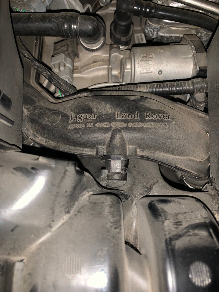

I would not remove that bleeder port without a new one in hand, it's just a bit of plastic and could be easily damaged. But because your system was serviced in May it should only be a few months old and therefore not too brittle so you might be able to get away with it.
Here is a photo of the port on the 2015 V6. Of course you need to remove the appearance cover first...
For orientation, this is pretty much dead center on the engine and as you can see it's right on top, pointing forward to vehicle front.
If you have the V8, I can get a quick photo of that as well....
The bit of plastic in the photo bottom, i.e. towards the front of the vehicle is the air intake plenum, that's a 2 minute project to remove, but you might be able to get that port on and off without removing the plenum - it's tight but there might just be enough space.
