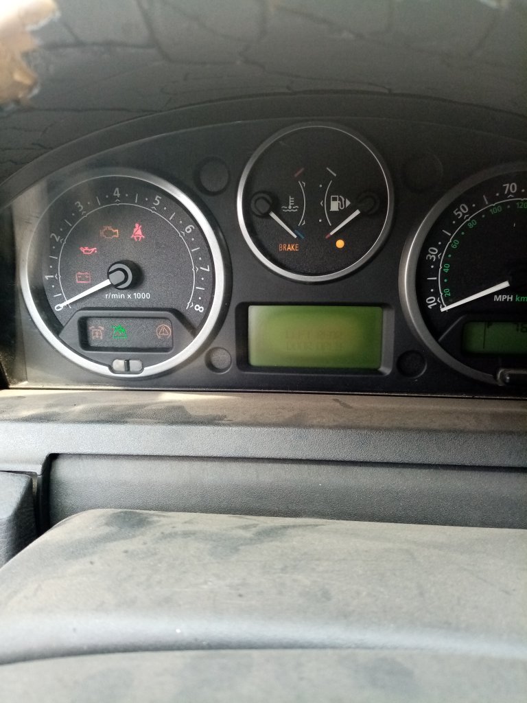

Hello everyone i have a land rover Lr3 and its displaying low range signal on the screen(flashing green lo light) and after scanning it has a fault code=Gear Shift position-circuit range/performance
Code 2=clutch position is not learnt...
Pls anyone with a solutuon.

If the codes are legit, then you have an electrical issue either due to water ingress or a bad hi/lo switch. For code 3 it sounds like a rear diff issue; hopefully just the (locking) motor and not the whole differential.

OK.... That's a good idea you have just given me.
Changed the transfer case module twice but still the same thing....
Will change the switch next
