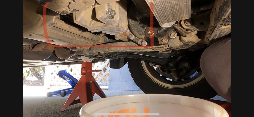

I recently heard somewhere that there's a difference in the oil pickups; the LR engine being better suited to still pumping oil through the engine when off-camber.

Fir reference this is the bottom of the Lr sump.
