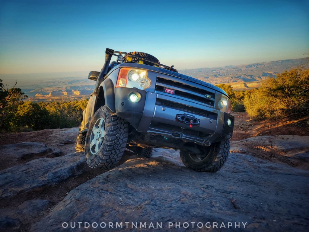

Please don’t run brighter lights in factory fog housing/reflector on the road. The factory ones are already a poor pattern and throw too much light up at other drivers. The Baja Design squadron is an excellent choice but not for on road use where you have traffic. Dedicated driving lights are the way to go.
I have led replacement bulbs in my factory fog units from Carid. Same bulb number as factory. They have an led array around the post to use the reflector, and a small projector lens on the front for greater depth of light forward. They work really well.
