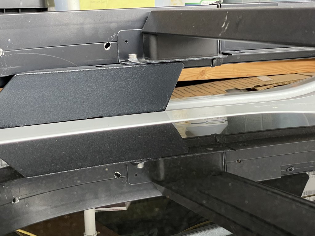

Chris Robert
Oct 7, 2020
Massachusetts
I have a Baja Rack that I was told would work with the extended rails. What I had to end up doing was to remove the footing at the front of the rail because the rack wanted to mount in the same hole. This left me with just kind of ***** extended rails that poke out, but with the rack on, it's hardly noticeable...
It's not clean or ideal, but it's not bad.
