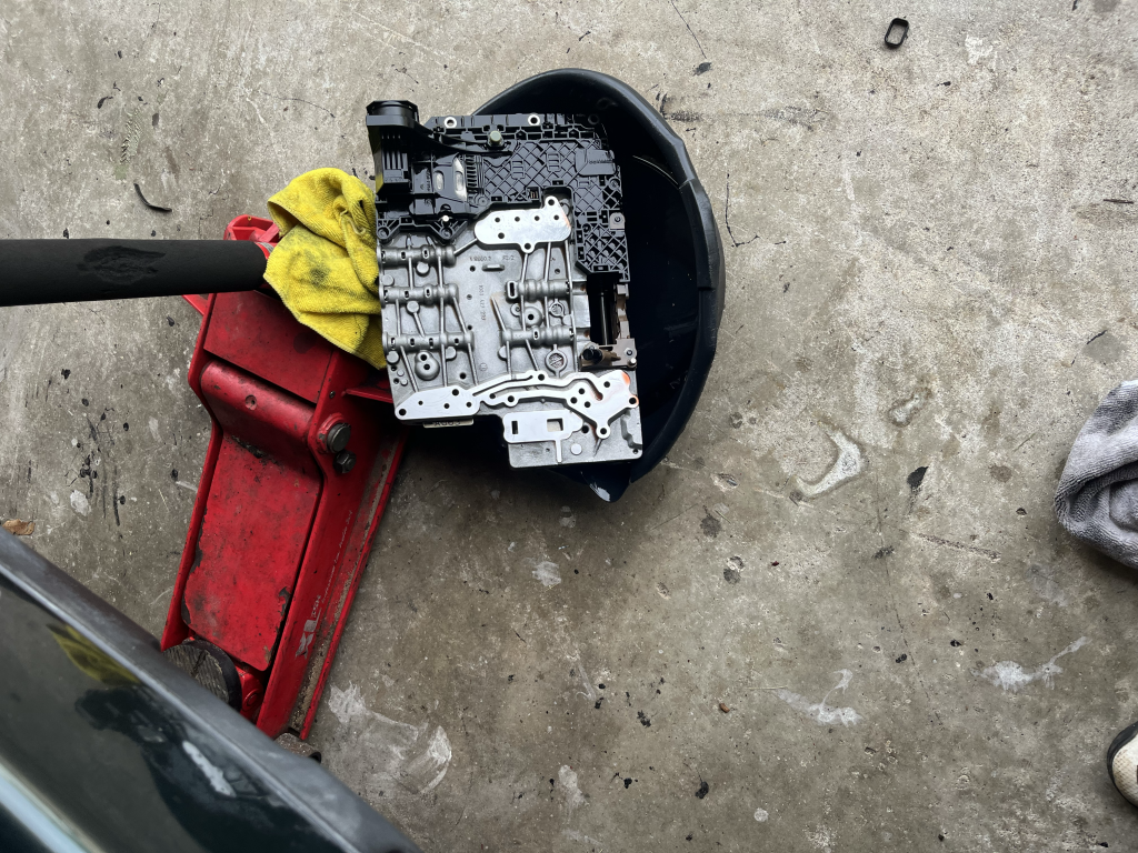

- I ordered replacement set of OEM Solenoids to correct a shifting issue and transmission fault that I received. I also thought I would take this opportunity to change over the trans fluid, sleeves, and covert over the trans pan/filter. I made the switch of solenoids, and when I placed the valve body back into the vehicle, closed up the tranny pan, and went to start the car to get the trans oil up to temp specs for adding the remaining 2 quarts, I saw a big fat "E" in the dash, where I used to see a "F". The only thing that had changed was the solenoids, so I quickly went to work taking the valve body back off, and going back with my original solenoids.
-Back to my original solenoids, with fresh filter/pan & sleeves, and when I placed my key in to turn the ignition on, I noticed that the dash indicated that the car was in D, but the shifter was still in park.....? I could not get the car to shift either out of park, and turning the key did nothing for me. The big fat error code of E was gone, but the car would not crank. I implemented the gear shift manual shifter through the side of the shifter and was able to slide the shifter through the gears. I went up and down the shifter column about three times, and stopped at N (nuetral) and wallah, I saw the "D" disappear from the dash, and feverishly began to turn the key........Virrrrrooooommm!! I am in business. I felt on top of the world, and breathed as if the worst was behind me. Assuming everything was fine, I turned off the car and went to clean up my work space. Yep, the key would not come out, and I went to start the car back up, and nothing.

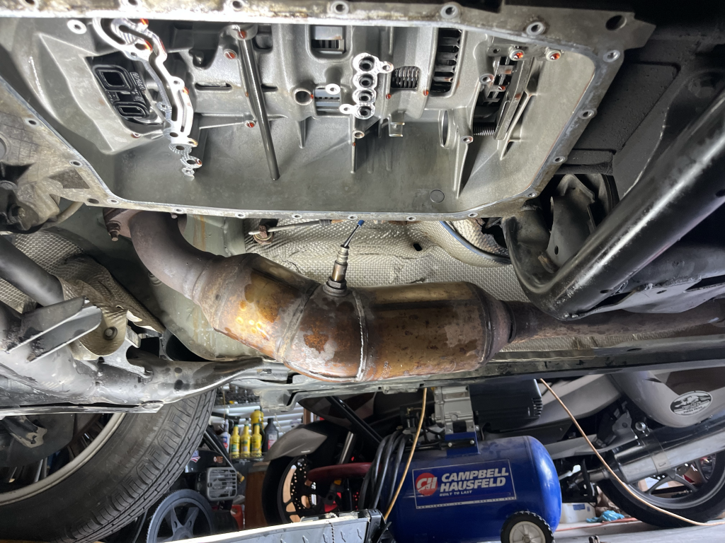

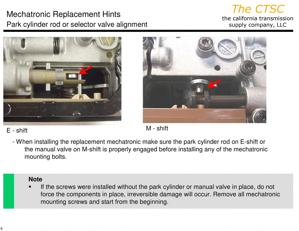

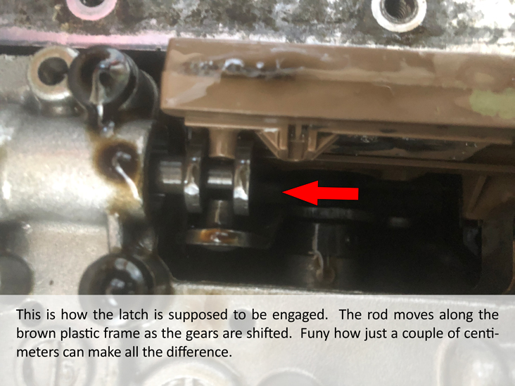

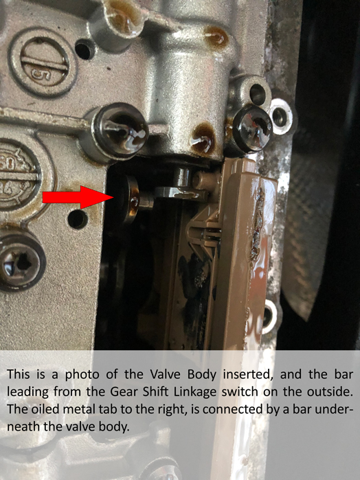

I am now convinced that I must have overlooked something in placing the valve body back into the tranny housing. Is there anyone who is familiar with taking these in and out, and can extend some possibilities of what my be either not engaged or not tightened that would cause the truck not to recognize what gear it is actually in? My assumption is that the LR3 thinks it is D still, and that is why every time I put my key in, I can not pull it out. I must say that when I hooked the harness up to the valve body sleeve, it did not go as smooth as it has gone when I have done it on other LR3's. This is the first time I have every taken the valve body off, normally I would just do trans pan conversions and valve body sleeve replacements. It rained the last 20 odd hours, so I have not been able to get back under the truck. I am going to go step for step in analyzing the connectors involved with the valve body, taking careful examination of the gear linkage (although it shifts fairly smoothly) and rub a rabbits foot along the outer edge of the pan for mercy from the maintenance gods.
Is there any cables that I might have loosened, or interrupted on the valve body, to keep it in a state of D (Drive)....or is there another area I should be investigating all together....??
