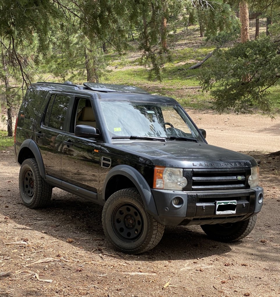

    I run the Lucky8 wheels with 275/65R18 on my '06 and I get minor rubbing at full lock. I like the look, they were cheap but they are heavy. I don't do any aggressive wheeling yet (need to add sliders, etc) but they've held up pretty well so far. They come with lug nuts but they will rust very quickly. Lucky8 is aware of the issue and hoping for a solution from the manufacturer.

    Weight is a concern. Good to know that 275/65 works with minor rubbing. Just to be clear is it the lug nuts, wheels, or both that rust easily?
  5. WestHamPaul
    WestHamPaul New Member
    Age:
    53
    Posts:
    Likes Received:
    Joined:
    Apr 1, 2018
    Location:
    Denver, CO
    Sorry, just the lug nuts.
