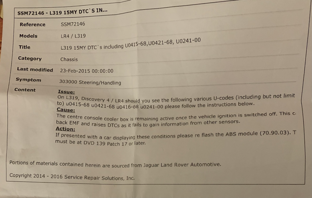

Any suggestions? I be not have a decent shop here that will address this. One code indicates that there was an electrical interference issue with the center ice box (which I don’t have).

SSM72146 - see attached - by the way, thank you all in this community for your support over the years! my guess is that I should buy a new compressor and self install it with the original so I don't need to re-code.
