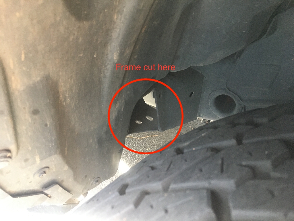

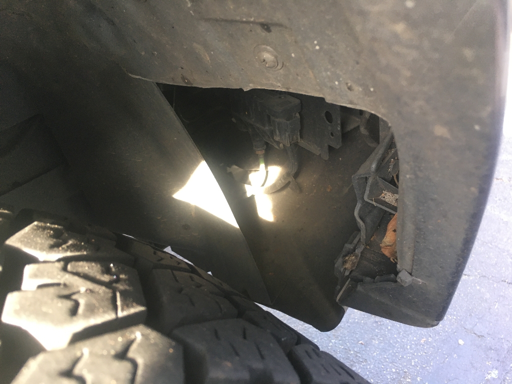

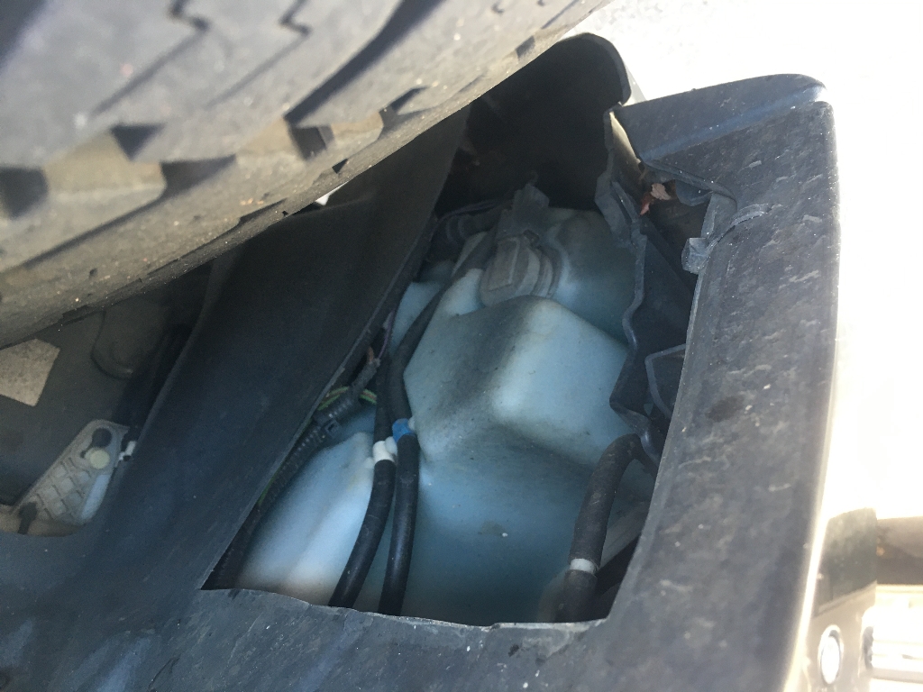

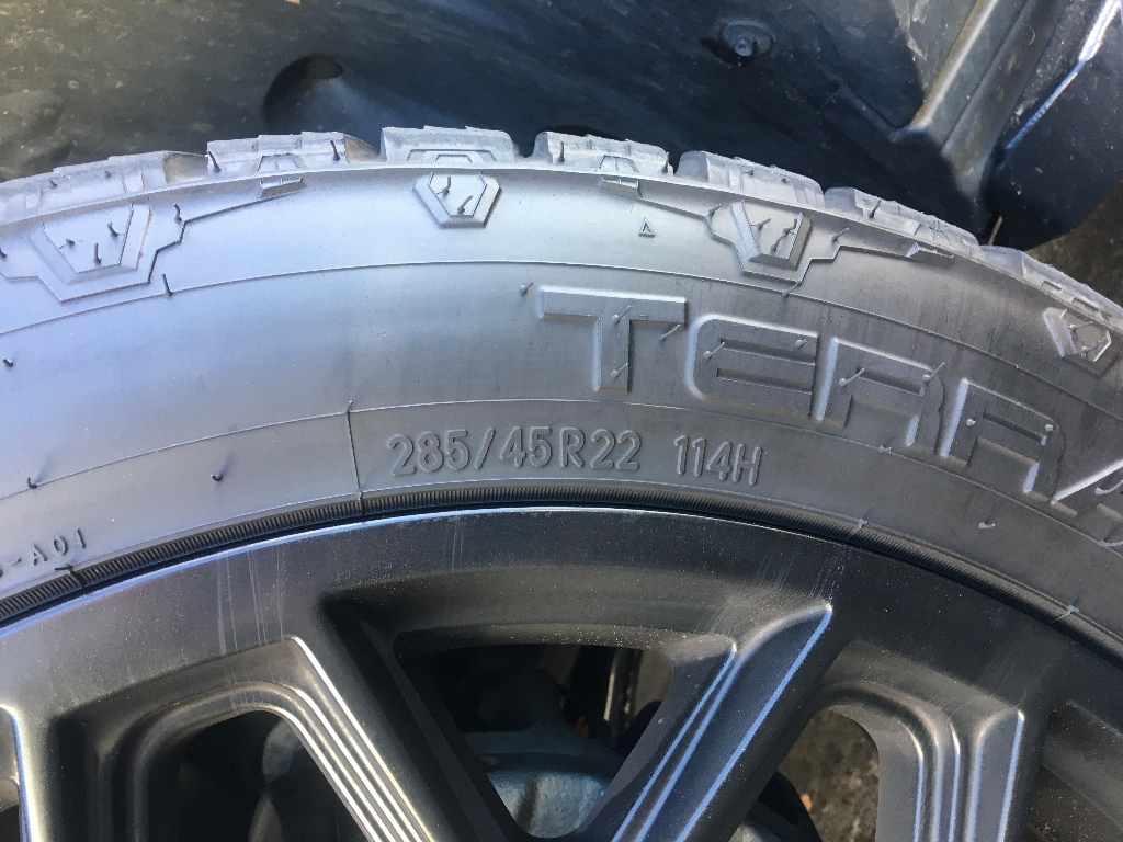

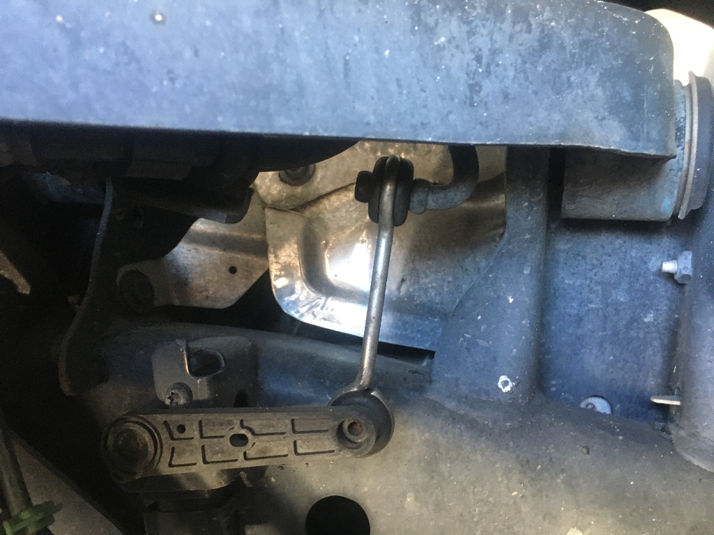

I saw this LR4 that was lifted (Johnson rods at least, maybe GAP tool also) and was rolling 285/45/22 Nitto Terra Grapplers. I was checking it out and he had done exactly what I’ve been thinking about doing to make room in the wheel wells. So I took some pictures (see below) and thought I’d pose a couple questions here. I don't know why but I didn't take an overview shot of the vehicle at the time, but it looked dope.
- Has anyone else made these modifications to accommodate larger tires?
- Would there be any adverse effects of cutting the frame where it’s cut? (I thought about cutting it like he did and even welding a plate to maintain strength/rigidity.)
- Other than a proper alignment, is there anything else that would need to be done to make this work?
- Any other reason why this wouldn’t work? I mean, this guy did it…

- Tire Size
- Rear of the driver's front wheel well with frame cut
- Driver's front wheel fender liner cut.
- Passenger's front fender liner cut.
- Rear of the passenger's front wheel well with frame cut

the fender liners in the those photos. dont do that. your opening up your engine bay and partially hidden componenets to significantly more water and debris infiltration.
the frame modifications are acceptable, but incomplete. a plate should be welded to close off the holes in the frame and also reinforce.

The other LR4 you found would be pathetic off road. Also I’d never cut my wheel well liners. Opening the engine bay up to debris like the other person commented is a horrible idea, and it doesn’t look professional. Looks like someone just took a hackzall to it lol

I totally agree about opening up the engine compartment to debris. Was just thinking of this as kind of a starting point and possibly fabricating a modified fender liner or some sort of shield on the inside of that cut open space. Definitely don't want dirt/mud getting in there. And yeah I would definitely finish the frame modification with a plate.

I’m not sure how I feel about cutting frame horns, since they serve a purpose in a car crash.
Cutting the wheel liner is awful in my opinion. There’s guys running 275/55/20 tires and seem to just require lift rods + the frame horn removal.
The largest (diameter) you can get on an LR4 is about a 31.5” tire. I know the LR3s can handle about 32”, and then that’s about it.
Too much **** is in the way. I don’t think you really have a choice. If you read through the 18” tire thread there is a lot of discussion about lift rods and cutting frame horns and what not, but the wheel wells on these cars are just too small. I suppose if you don’t off road you may be able to get away with some rubbing.
