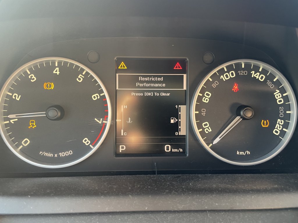

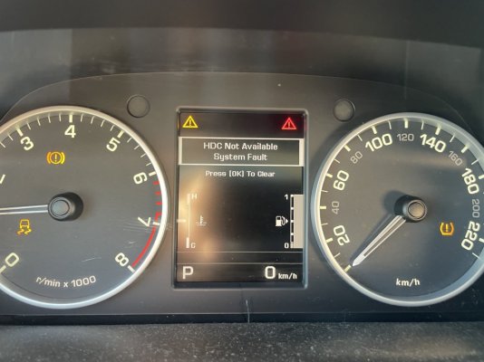

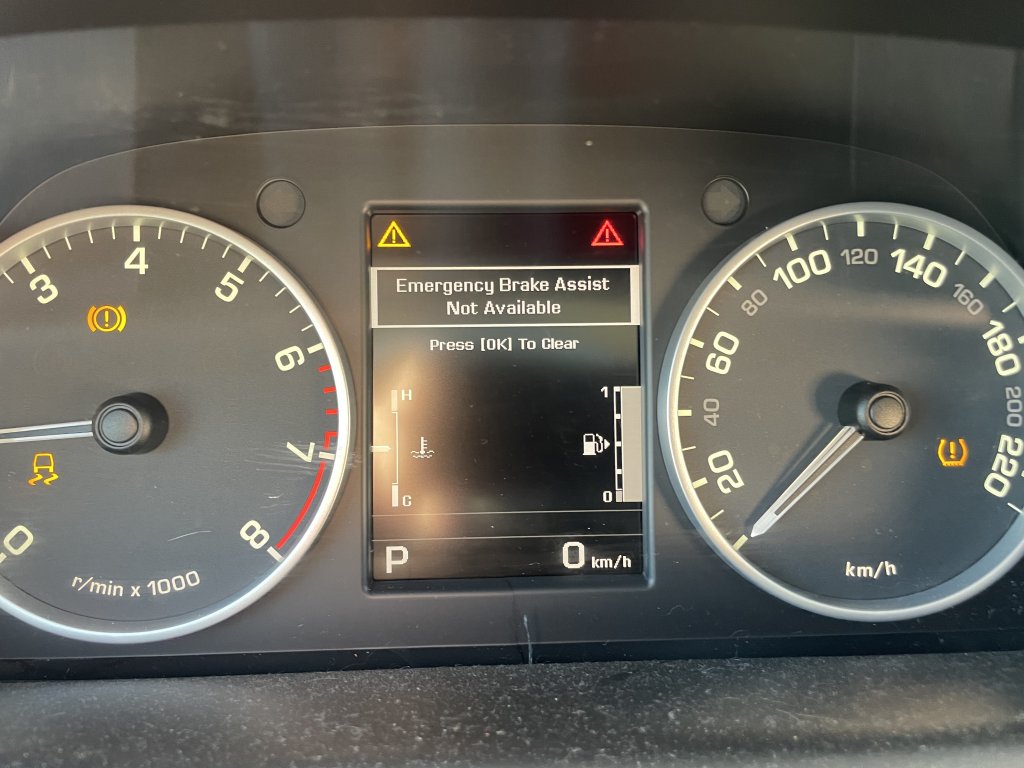

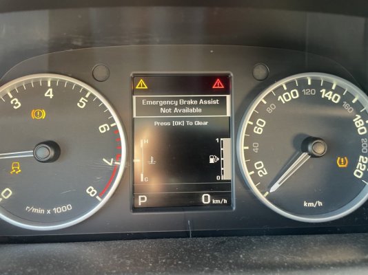

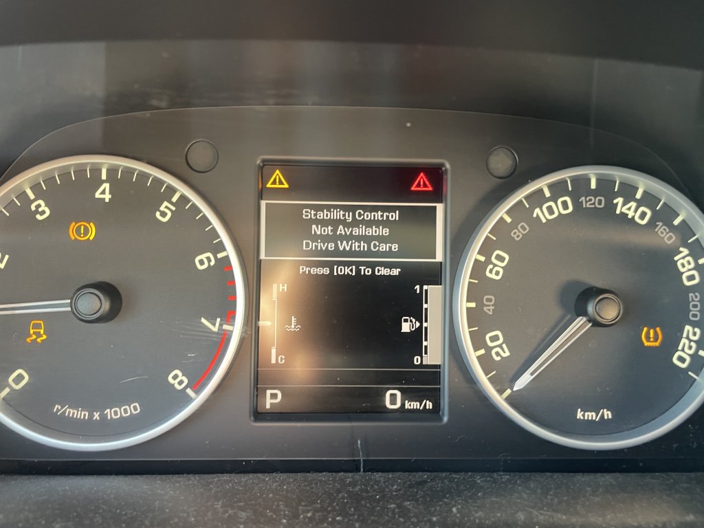

Hi All, my 2012 LR4 5.0L V8 started saying restricted performance 1/10 times we would start it. Local mechanic couldn’t figure it out and it would throw off codes. When this would happen, we would have 10% power, and all our systems seems to shut down (pics below).
Richmond, BC, Canada LR dealer found that it was the throttle body:
“The Rough Idle and SLuggish Acceleration is coming from a faulting Throttle Body. The Throttle Body is a valve that is timed by the Powertrain Control Module to open and close a valve to allow air to enter the spark plug chambers. When the Throttle Body Failes. it does not open at the correct time and it causes a misfire in your engine. You would need to rplace the Throttle Body to correct this issue $1649.00 plus tax including the diagnostic time.”
Hopefully when I get it back, it’ll be smooth sailing.

Have you obtained any of the codes? Please keep us posted as to what the results of replacing the throttle body are. Mine began to go into restricted performance mode on cold start up, cylinder 1 misfire. The check engine light would blink, then stay steady. I don't get the HDC and e-brake not available notice as you do. The only time I saw those codes where when it was power related, hence I enquired about the battery.
