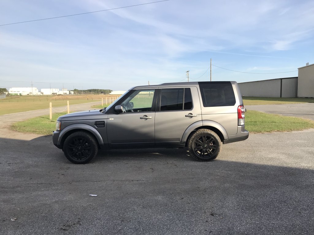

does anyone else think the ass end of my LR 4 is higher than others? idk if my OCD is just ******** or if im use to my Range Rover I had before this which sat at a totally different attitude but I really feel like the back sits abnormally higher than the front compared to other LR 4's I've seen
jwest
Mar 22, 2008
2,041
409
Seattle WA

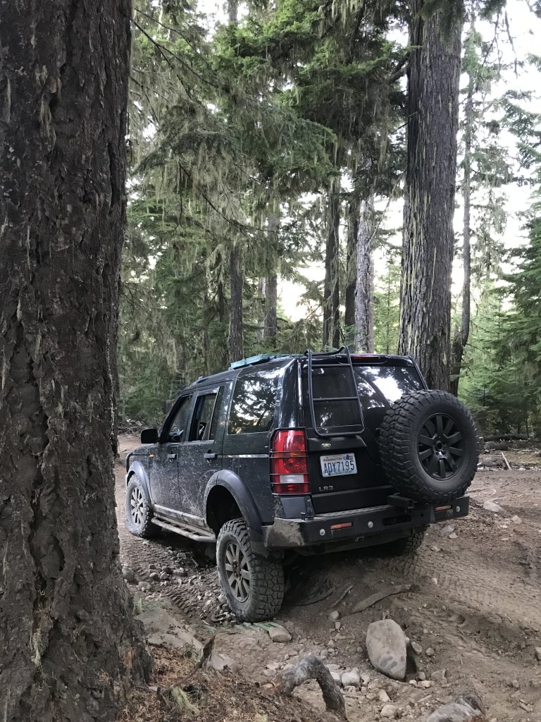

No it looks perfectly correct. Bad photo angle and shade vs sun. Plus, the lr3/4 do keep more fender gap at the rear with my hunch being it’s because the lr3/4 are expected to actually haul more than a superbly riding Range Rover.
You also have to realize that the rear will just be off if the front is on ground slightly different slope because the vehicle is front priority leveling. You can see this more off-roading where front is on level ground while rear tires are all over the place.
Example:
