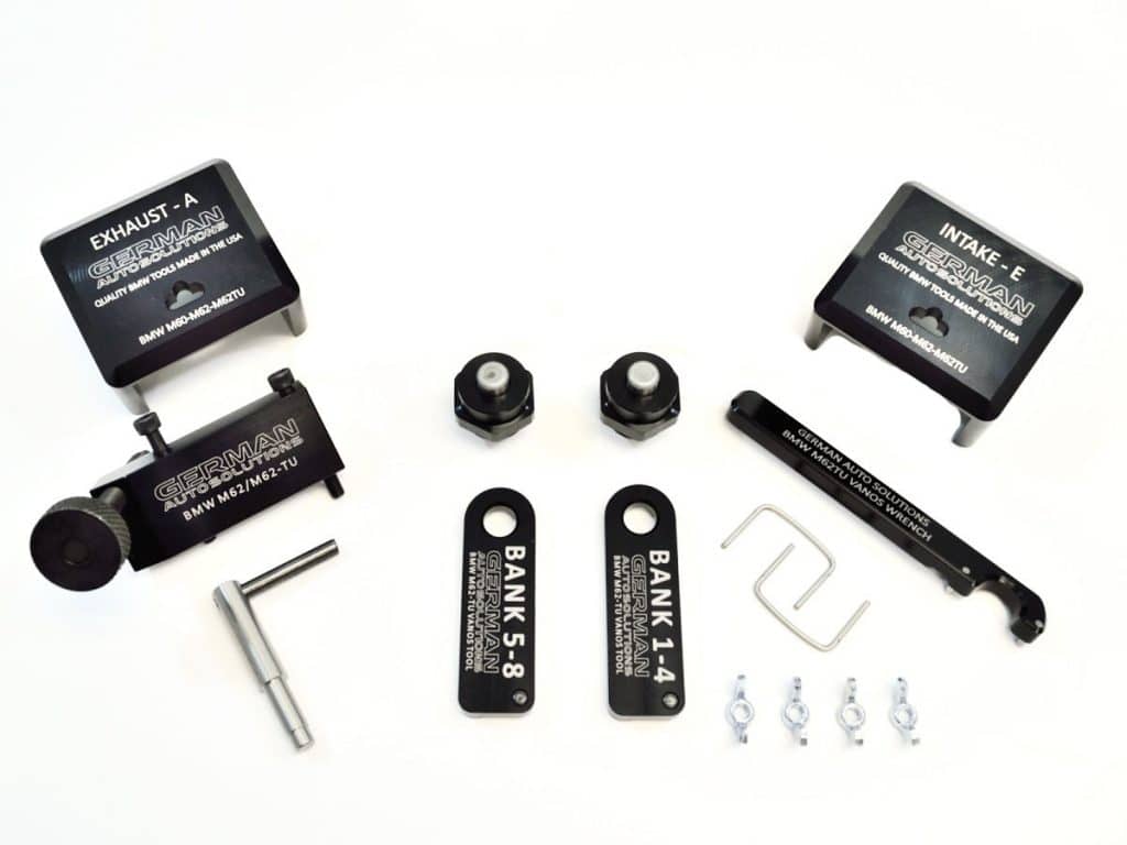

I'm not a Land Rover owner, however being that your engine is BMW we share the same condition I'm afraid. My situation is further progressed than yours because my engine has 180,000 miles.
If nobody here can guide you in the correct direction i have a link that might be helpful.
