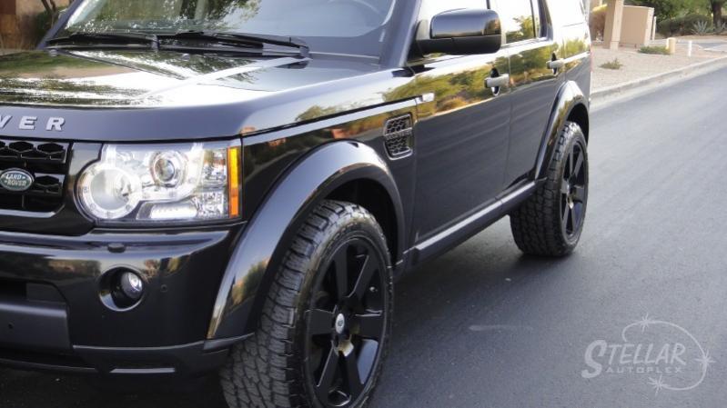

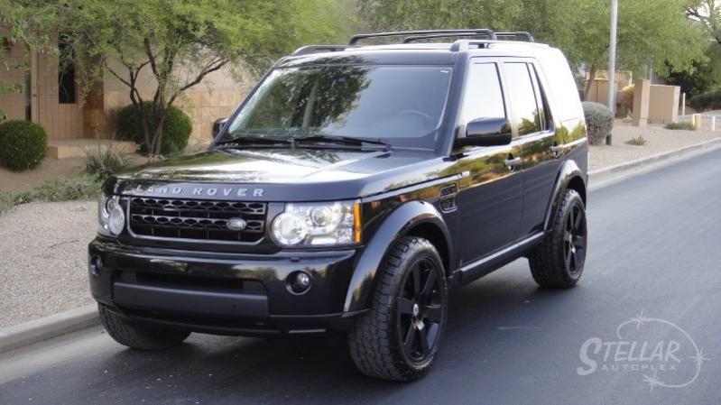

I'm pretty sure these are 20" Redbourne wheels....Nitto Terra Grapplers

The photo above is bound to rub at most turning situations, worse on low while in parking garages and worse yet in any situation where there is wheel articulation. You can see by the photo the offset will cause the rubbing when turned much either direction.
It looks cool for sure, but it is essentially a very poor choice.
