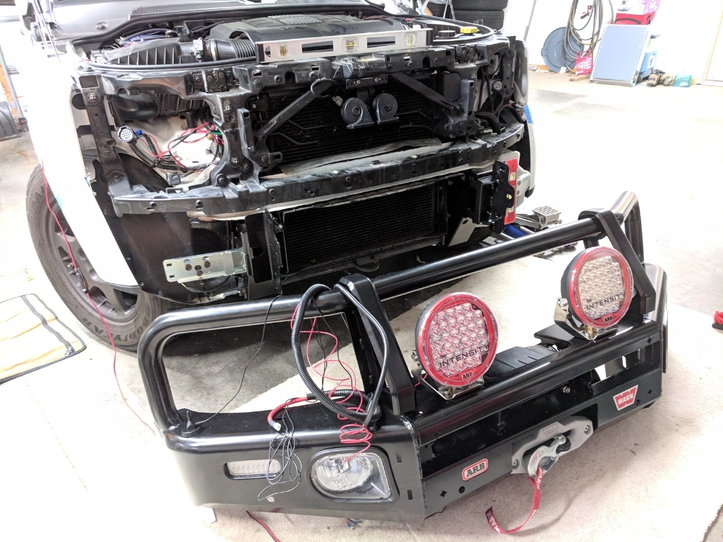

    I did my ARB install myself. I just worked on it in the evenings after work over the span of about 4 days, a few hours at a time. Then at the very end just had a neighbor come over to help lift it. I got a big piece of carpet and just put it on my garage floor to work on the bumper.. so it doesn't get all messed up as I move it around and work on it.

    Impressive! Is there a thread here in which you posted the progress when you did this? Where did you mount the switch for your lights your of curiosity? Thanks again!
