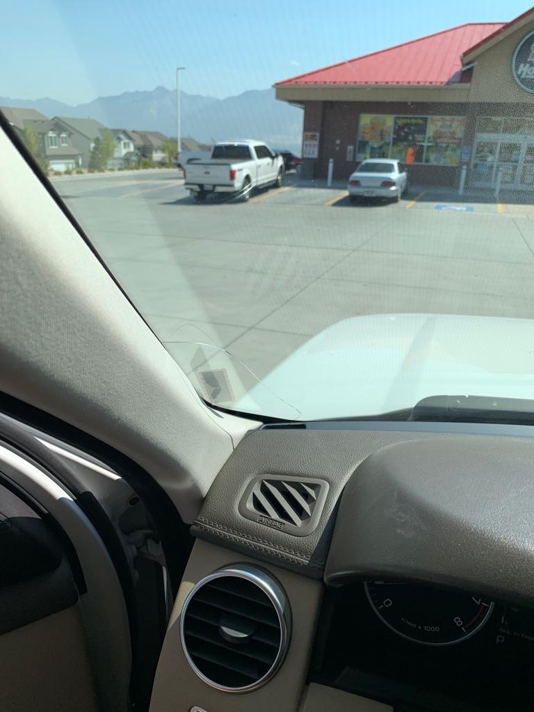

Hey all, I did a quick search on forum titles and didn't see much so thought I'd post. If I missed any long threads on this, feel free to refer me over to them.
I have a split that has developed from the roof straight down through the windshield on the passenger side that's about 1/3 of the way towards the hood of the truck - so probably about 8"-10" long. Seems more like a windshield replacement than a get-it-patched type situation.

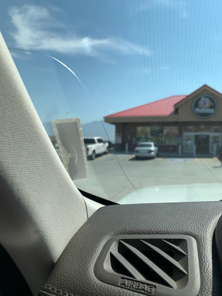

For real! Mine is lower and less visible, and probably shouldn’t bother me... so I’m trying not to care, but as you are aware, it’s like an unscratchable (not a real word, it’s fine) ITCH!
