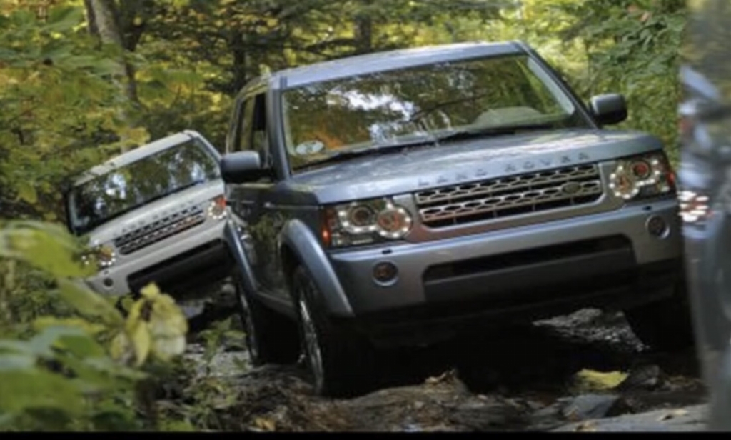

    So these trucks shown in pics are driving with parking lights on to enable LEDs?
    [​IMG][​IMG]
  6. ryanjl
    ryanjl Full Access Member
    Posts:
    1,154
    Likes Received:
    471
    Joined:
    Location:
    Yeah, I suppose so.
    You can put the 2014+ headlight housings in a 2013 or older LR4. You'll need the GAP tool to enable the DRL LEDs, and you'll also at least need an updated 2014+ grill. For the full swap, you'll need a bumper for a 2014+, but powerfuluk makes a little trim piece that can fill in a gap and let you keep using your current bumper (it's also a good place to buy the 2014+ grill).

    I’ve considered the newer lights but the costs of those with xenon lights alone are nuts. The grill and trim pieces are not bad and they all look great but I was hoping to just get my LED fix without spending a ton.
    I swear I’ve seen stock trucks running around with just LEDs on while driving without headlights. I know they aren’t likely doing a jumper either.
