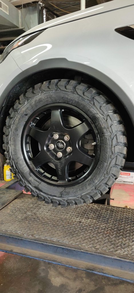

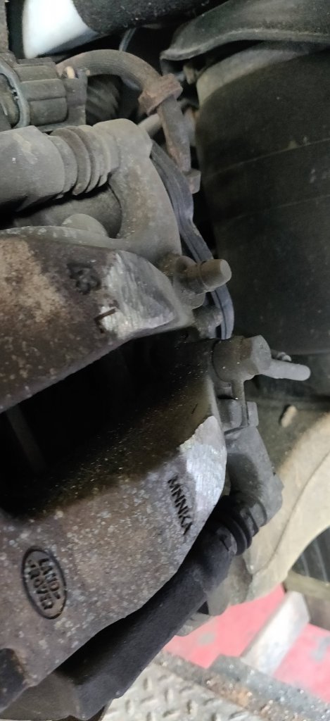

I got them to work. I had to grind 1/16 off the peak of the rear caliper.
