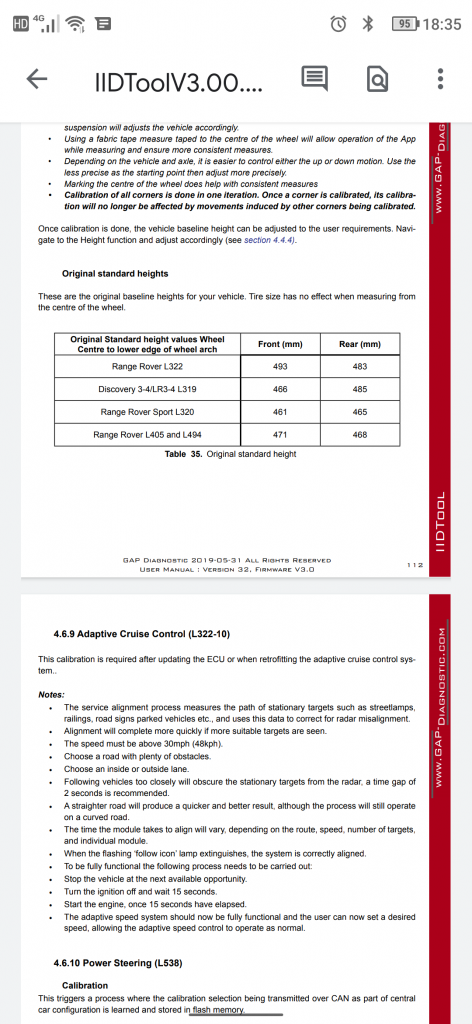

Found it for you. OEM setting:
What it needs to be calibrated at:
Front: 530mm
Rear: 549mm
Measured from the center of the wheel (think the center of the axle) to the bottom of the wheel arch
