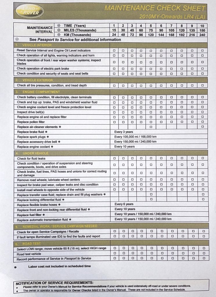

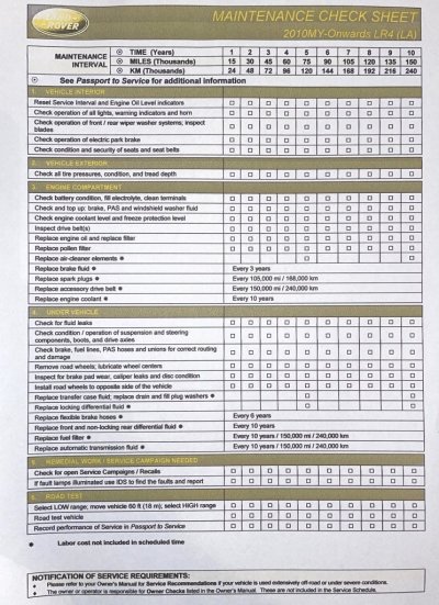

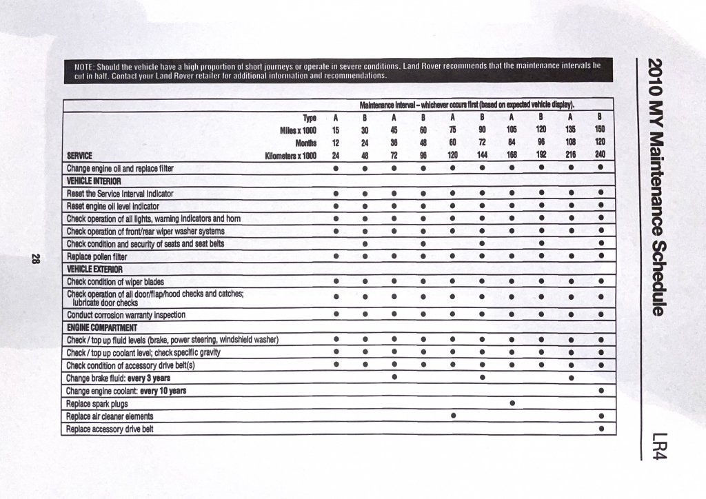

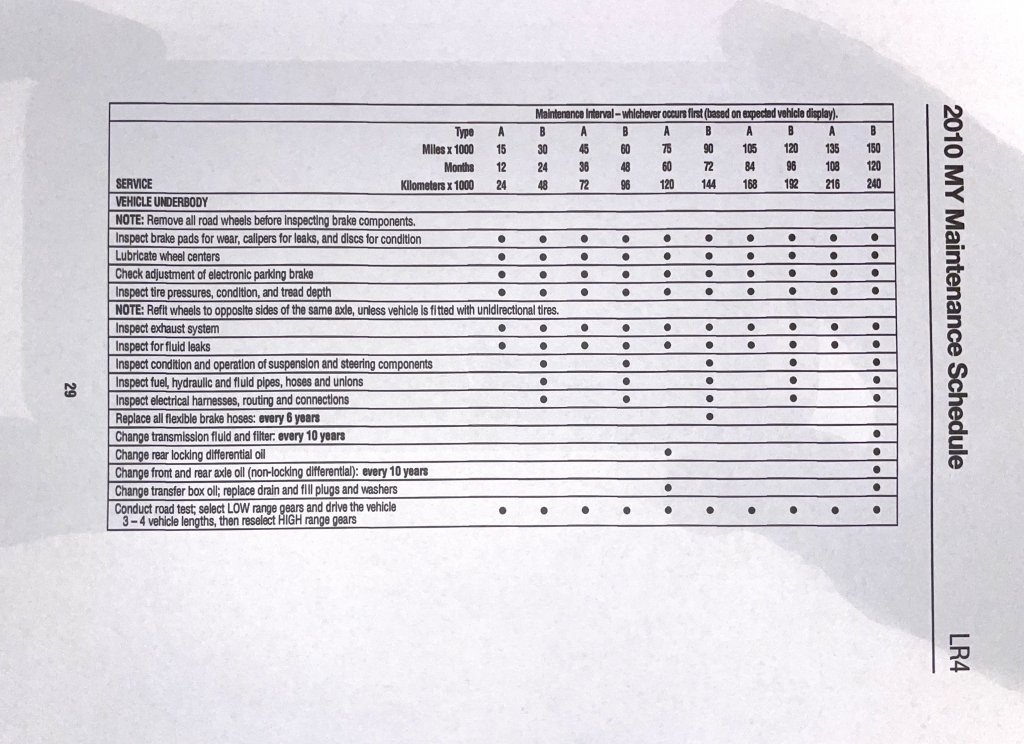

I've got these maintenance schedules, which are for MY 2010-2013. I didn't have time to scan properly so I shot with my phone, excuse the quality.
