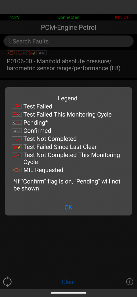

2012 has started turning on MIL yellow check engine light. Relevant code is P0106-00 and probably going to throw a new Land Rover $150 MAP at the issue.
