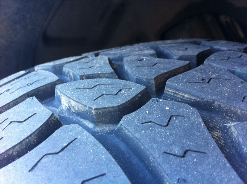

The tires have a unique tread pattern, which was one of the things that attracted me to them. The lugs are well spaced and the tread to void ratio looks decent. The gaps vary in size from about a quarter to a half an inch. Tread depth is 12.5/32nds or 10mm as specified. Each tire weighed 44lbs, and they balanced easily with minimal weight.

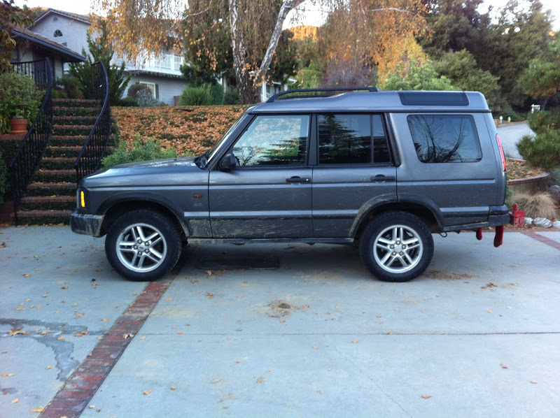

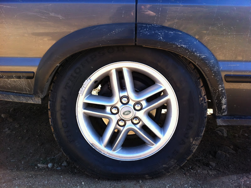

The stock tire size for the Discovery II is 255/55R18; this is a 29” tall tire. I purchased the STZ’s in the 265/60R18 size which is 30.56” tall according to Mickey Thompson Tires. This is accurate as far as I can tell; using my Stanley tape measure they come out to 30.5”. Installed on the vehicle the tires stand about 30” tall. These tires fit really well on my vehicle. They raised the vehicle by about 1”. With the previous tires (255/55R18 Nitto Terra Grapplers) the top of the front and rear wheel arch was 32.5” with the new tires it sits at 33.5”. I drove it through a little ditch near my house to see if they rubbed and how they would fit in the wheel well. These look like the size that should have come stock. They don’t rub anywhere; they stuff in the wheel well nicely and still have an inch or so of clearance. Under full articulation it looks like there will be just enough clearance to run chains. If the plastic fender arches were removed there would be more clearance.

New Tires
Tread Detail

Still an inch or so of clearance between the tire and the fender trim. There is even more clearance up in the wheel well. Sidewall is compressing slightly due to additional weight.
