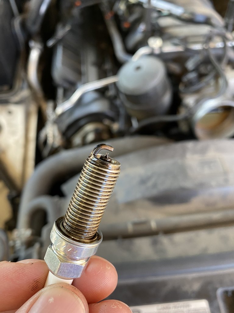

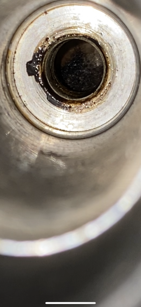

4. Took spark plug on #5 back out to check the condition and it is covered in oil on the threads
(Fairly sure it is oil as there doesn't seem to be any fuel smell)
Also worth noting there is no evidence of oil in the spark plug channel indicating a valve cover leak.
