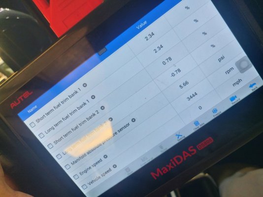

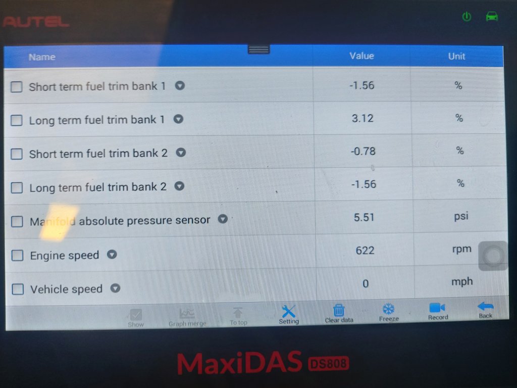

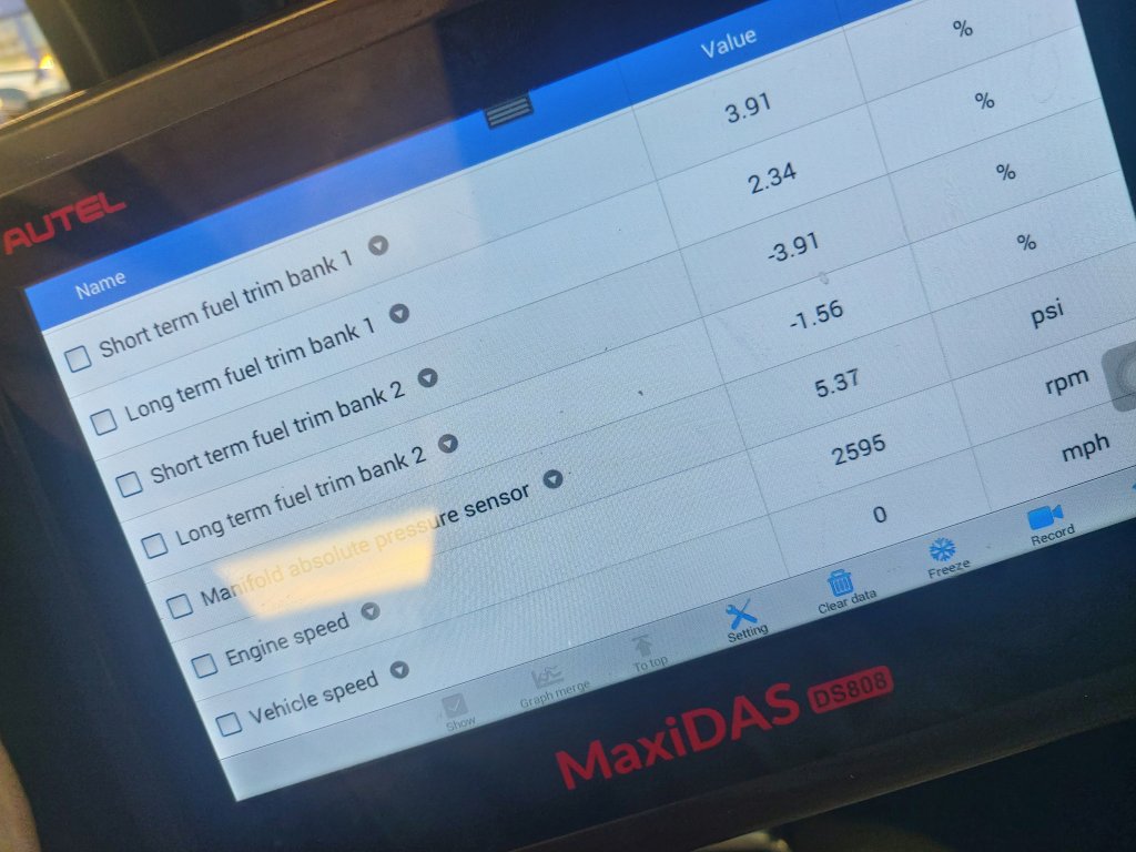

I replaced the last remaining O2 sensors that werent already replaced (bank 1 s1+s2) and i believe it fixed the fuel trims (please see attached pics) - even though oddly my misfires were mostly on bank 2 - numbers are much closer to 0 now
I am starting to suspect the MAP sensor for some reason, as you can see the MAP is around 5.55 psi - what should the reading be? Is that normal?
Reason is if you remember I had a heavy metal clunking noise in the supercharger, which did not go away even when replaced the isolator...
If the MAP pressure is ok my next plan is to check the CATS and any manifold/exhaust leaks...

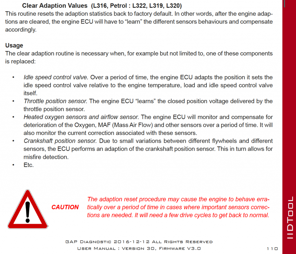

Here's my 2 cents and take it with a grain of salt. With all those new parts, have you tried clearing all the adaptation values? This will force the ecu to relearn new values, which means that it will reset to factory fuel trims. It will relearn all the fuel curves over a few days of driving. Some people will argue that all new vehicles and ecus are adaptive learning, and I will argue that a computer still needs to be reset (like clearing the cache to stale data) to perform properly every once in a blue moon.

I don’t know the normal MAP values - I’ll try to check mine tomorrow. But it does seem like MAP should be changing more than it is with increasing RPMs. I don’t remember the heavy metal clunking noise in the supercharger, and I can’t imagine what part of a supercharger would be making a heavy metal clunking noise. Is it still making that noise? The supercharger does have a bypass valve - I wonder if that might be malfunctioning.
But the fuel trims look better, so you’re making progress. I’ll try to report back map values tomorrow.

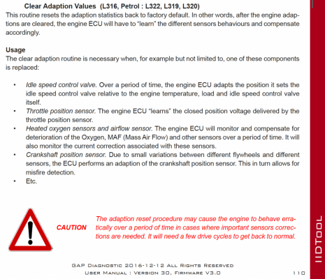

From my understanding, you don't have a Gap IID Tool. So, you'll probably have to ask someone that has the proper tool to do this for you. IF this costs money to clear the adaptation values, then I would suggest putting that $$ towards the Gap IID Tool. It seriously pays for itself and you'll have a vast amount of peer support for the product to get you through things like this.
Here's a snipit of Gap's reasoning of why you should clear the adaptation values, which is why I suggested doing so.

Just reporting back on the MAP values. Mine look similar to yours, about 5.8 psi at idle and 5.3 psi at 1500-3000 rpms steady throttle. It does change quite a bit if you blip the throttle.
