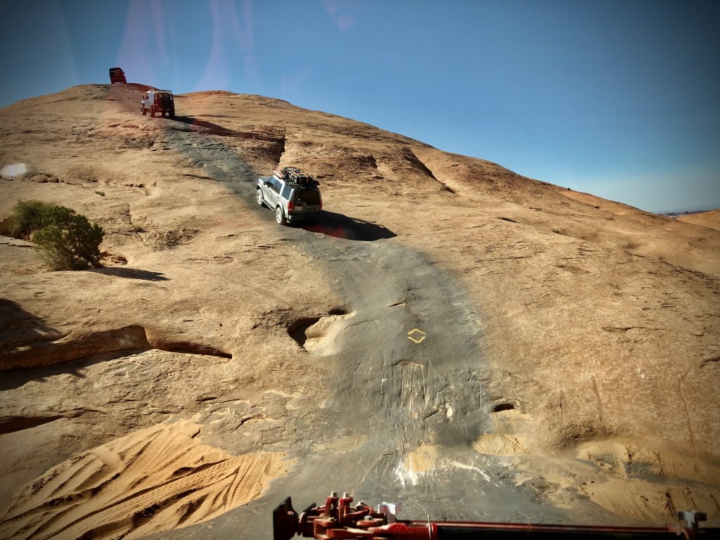

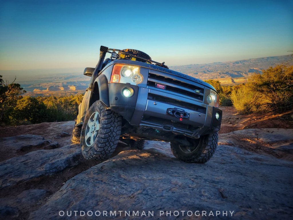

I was at the National Rally last September in Moab with my LR3 on 33” tires. We did hells revenge and Top of the World I’ve got a heavy rig with steel roof rack and load that I’d say is close to what a decent RTT weights if not a bit more. I also had a full load in the boot. For clarification I’ve got 2.5” lift rods, and additional .25” lift up front to level it out. I keep it out of off road height as much as possible. I have the SYA kit with 2” spacers (does not lift it, but puts struts back down closer standard height/inflation) and limiting straps to help avoid axle breakage. There were multiple off-camber times on Hells revenge that made me pucker for sure. One I for sure thought we were going to flop over. I dropped it to access height and not sure that helped as the suspension gets super soft there. I accelerated through against all my senses and made it through. I don’t ever need to do that trail again. Lol. Top of the world was incredible. There are a few bypasses you might want to take, I only took one and looking back could have done the hard line. I did have front bumper damage from that trail.
