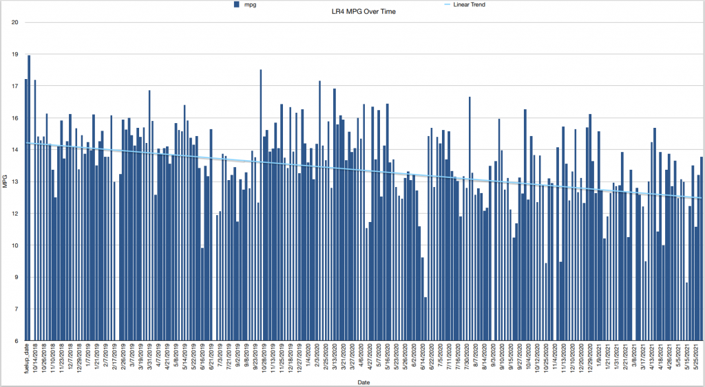

Anyways, I've owned my Discovery for 51,000 miles now, and have charted every single fuel up. (Date, gallons, odometer)
As a result, I have a great history of my car and everything I've done to it. I bought it with about 43k miles on it and now have 94k miles. $10,000 worth of fuel later and almost 3 years of ownership.

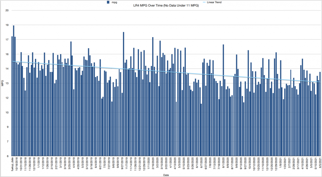

Anyways, what I've been seeing is a decline in my average MPG. I do a bit more towing now, so the second chart has any MPG below 11 phased out, but it is still on a steady decline.
I have not replaced my spark plugs or cleaned my fuel injectors. Those are the things I'm really wondering about, so I might do something about that soon. I did have a pretty bad wheel bearing a while back, and replaced the front as a set, and the dealer had replaced one of the rear bearings a long time ago. All of the wheels seem to spin freely and without much resistance.
I also got larger tires, and expected a hit from that, but it didn't really change much (255/55/19 to 255/60/19)
Besides the additional towing, driving habits haven't changed much. I moved to a hotter climate which runs the viscous fan more, so that could be impacting this as well, but even my 100 day 200 day average is still on a decline.
Anyways, here are photos of the graphs, I've also attached PDFs if anyone prefers that format.
Not sure if this is interesting or if anyone has their own data like this, but that'd be awesome if anyone else keeps track of this kind of stuff like I do. Engine probably needs some work, and I'm sure I could swap out all of the other fluids as well.

Here's the chart with nothing under 11 MPG taken into account

I don't have any exact data, but I know that after 132,000 miles my average mpg is lower than ever. And that is just based on the onboard mpg calculator that isn't that accurate. When the LR4 was new, I could hit 20 mpg on a long distance highway trip. Now 18 mpg is about max, despite being really well maintained. New spark plugs at 90K, always premium top tier gas, replaced bad hubs, bearings, dragging brake calipers and more.

How many horses have escaped? I wonder if anyone has dynoed one of these trucks.
Engines wear, things get tired and dirty, yes I’m referring to you inlet valves, power drops off, more loud pedal for a given speed and acceleration.
All pointing to a slow decline, a bit like me really.
You’d be really complaining about mpg if it were a petrol land cruiser.
But keep on roverin :)

I did a quick google search but didn't turn up anything: I wonder what is a "normal" loss in MPG for a vehicle correlated with odometer reading?
To the OP, great data capture!
