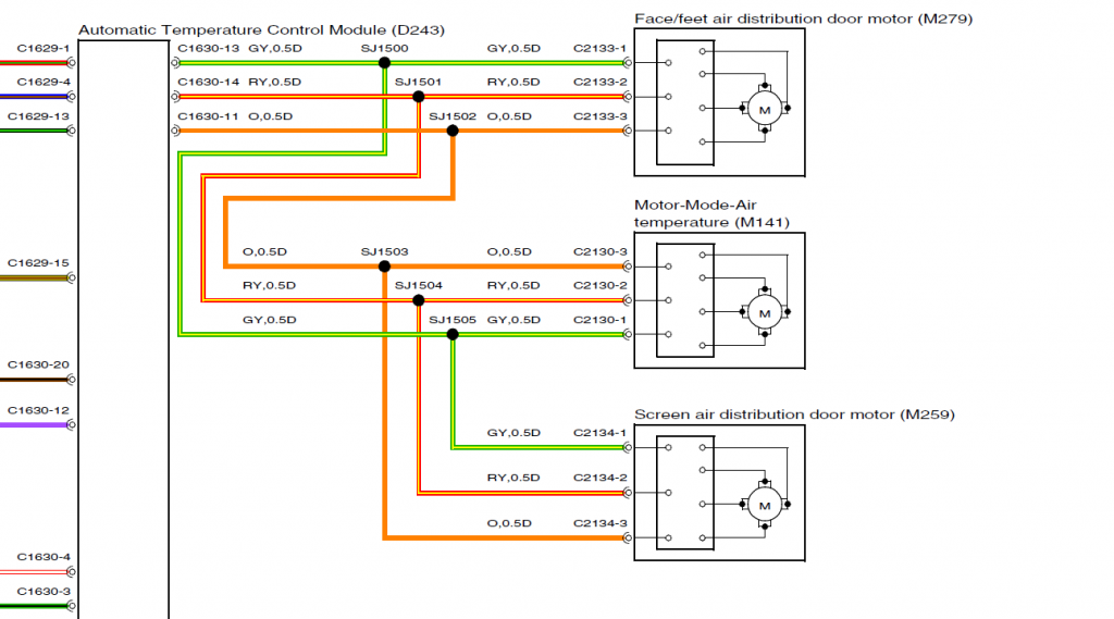

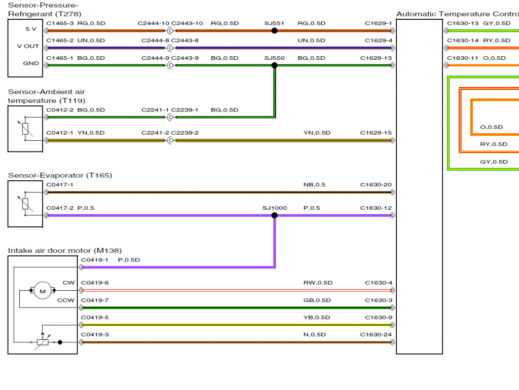

Was fixing stuff related to sunroof leak and dislodged/broke a small brown wire. Researching the wiring diagrams I found two connectors the wire might have pulled out of. But I don't know how to visually identify them. Was hoping someone had a picture and pinout.
Thanks.
