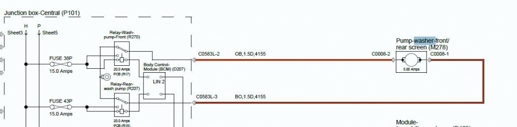

Noticed my washer fluid stopped working the other day. We had a flash of cold weather (0F) recently and at first I thought the reservoir might have frozen on me as the car sits in an unheated garage. Perhaps someone added water without my knowledge but then I noticed I can't even hear the pump running so I suspect the pump may have died. No noise, no nothing. So then I started with the obvious and checked the 15A fuses (position 38 for the front screen washer and position 43 for the rear screen washer) behind the lower glove box and both were fine.
So, my questions are these:
Are those even the fuses for the washer pump?
Are there two washer pumps?
Is there instead an underhood relay that covers both the pumps, assuming there are two pumps? Seems too coincidental they both went out.
Is the only way to get to the reservoir and I assume the pump location by removing the bumper?
I'm just trying to exhaust any self-diagnosis I can do that would prevent me from having to go to the dealer. I do have an IID scanner but just purchased it and wouldn't know where to start with it quite yet. Knowing my luck I'd probably screw something else up! Thanks guys!
