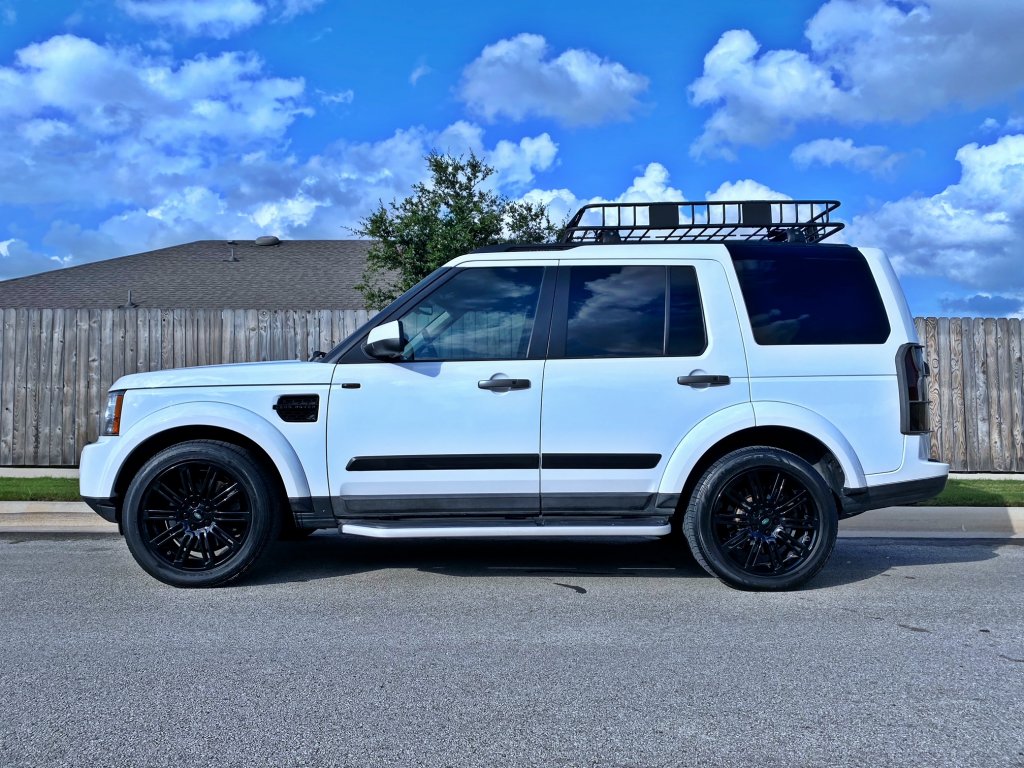

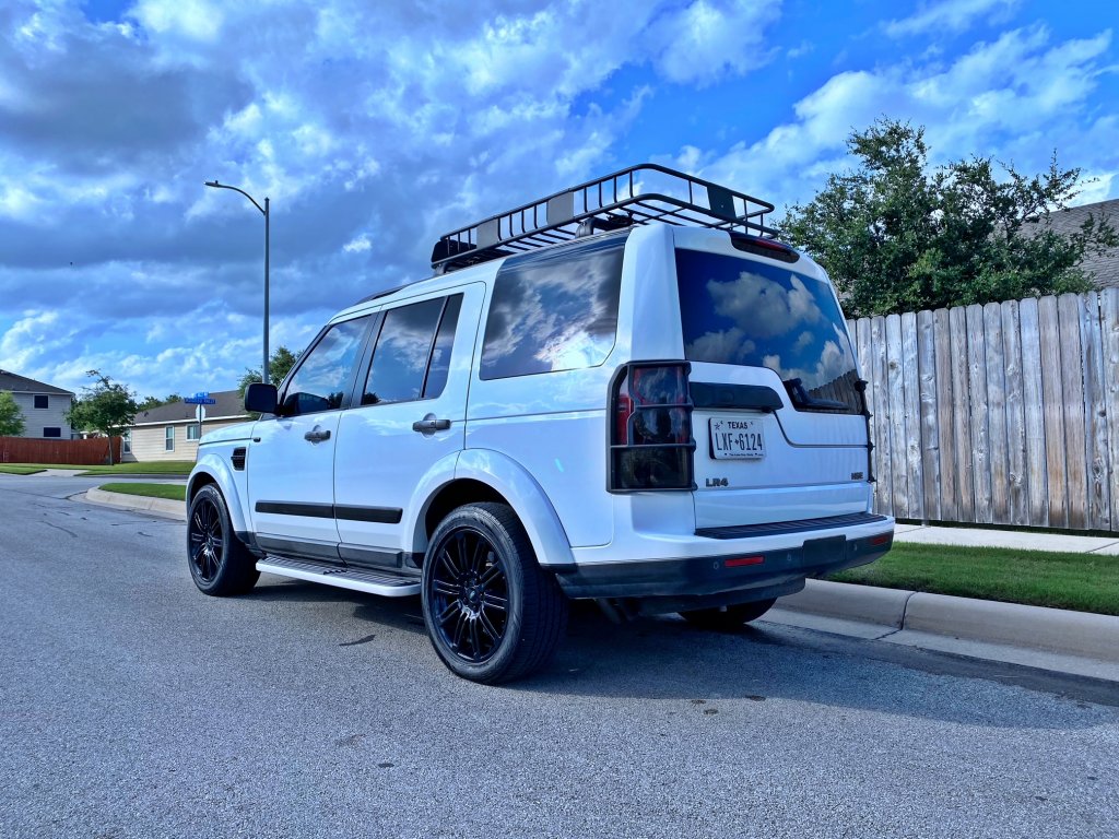

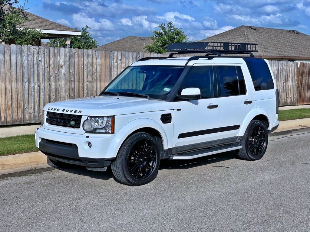

View attachment 13261 View attachment 13262 View attachment 13263
