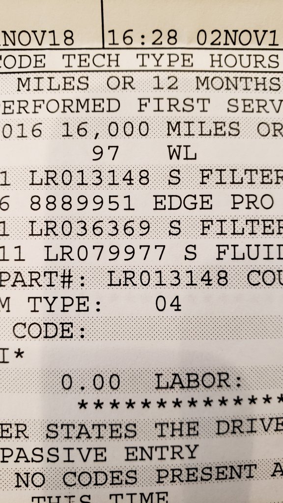

Greetings to all members. We recently purchased a 2017 LR5 TD6 3.0 and so far love the car. It is my second JLR product and despite the reputation this far they have been good vehicles. The local dealer however is another issue. The vehicle was sold to us with a previous accident history not being disclosed. However that is a story in itself and has been settled. It has left me with a bit of trust issues.
So this week I took the Disco in for its first complimentary service. I asked the generally incompetent SA about the type of oil they use and he could not answer. I told him this model requires a very specific ACEA C1 oil due to the DPF which he knew nothing about.
So now on my invoice it shows they used all JLR parts except the oil which is a Volvo part number(they are also a Volvo dealer) PN# 8889951. I cannot find much info on this oil. It is a Castrol Edge product but I believe it is a A3/A5 category oil.
Before I keep driving the car and start accusing anyone of a mistake can someone please confirm if this is the correct oil. My wife thinks I am nuts. I am very particular about my cars and I would like to try to drive this thing for a long time. Yes I have warranty but regardless I do not want to damage anything.
Your advice is appreciated. Photo of invoice is attached. Thanks in advance.

As you know, the oils in the links below are what you want, although I am unsure what the difference is between the Pro and "non-pro" versions.
It seems doubtful Volvo would specify the same oil, they do use a Castrol 5W30 in a few engines, but not a C1 that I have seen.
https://msdspds.castrol.com/bpglis/...070D0E58025827C00542CC3/$File/BPXE-AYLQRU.pdf
https://msdspds.castrol.com/bpglis/...EACB16880257E8B00705E64/$File/BPXE-9Z23WQ.pdf
Here are a couple other oils that can be used as well if you decide to DIY:
https://www.amazon.com/Ravenol-J1A1571-001-5W-30-Motor-STJLR-03-5005/dp/B07256JN9N
http://www.liqui-moly.eu/liqui-moly/produktdb.nsf/id/en_3724.html?OpenDocument&land=DE

i looked up that part number which shows up as a volvo oil part number. volvo description on amazon says castrol edge full synthetic. catstrols web site shows this list of datasheets for castrol edge 5w-30:
Product Name Country Language
Castrol EDGE 5W-30 A3/B4 USA English (US)
Castrol EDGE 5W-30 A5/B5 USA English (US)
Castrol EDGE 5W-30 C1 USA English (US)
Castrol EDGE 5W-30 C3 USA English (US)
Castrol EDGE 5W-30 LL USA English (US)
Castrol EDGE 5W-30 U.S. USA English (US)
Castrol EDGE 5W-30 USA English (US)
EDGE USA English
EDGE
You should try to find out what the volvo part number means exactly. there has to be a datasheet or maybe the dealer sells it in quarts? you can look at those bottles? you could even call volvo corporate or call castrol customer service.
