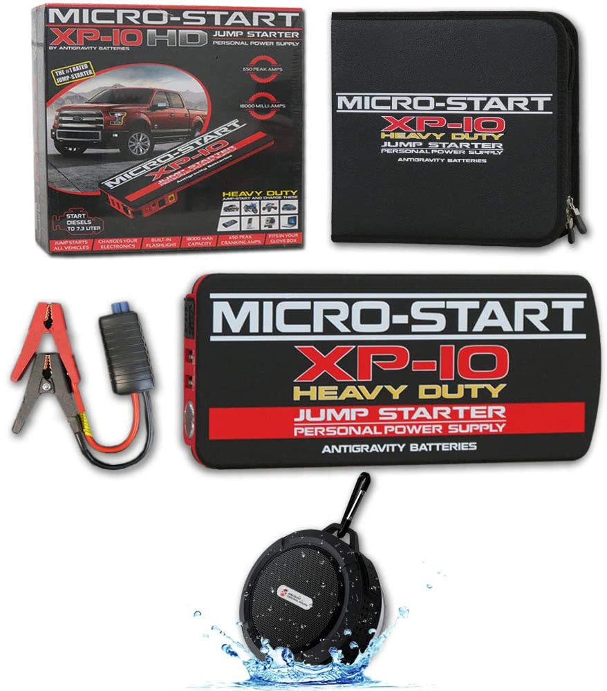

    Ya, I always carry one of these both for my own backup on trips/off grid and also so I can help people out. I don't spend so much on a capable rig to turn people down and not help.
