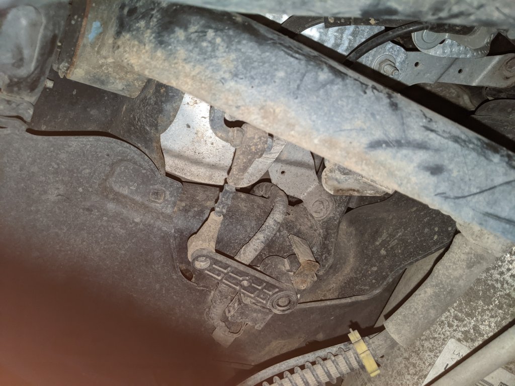

Did they replace only the lower arms, or was there any work done on the upper arms? The height sensors connect via rods to the upper control arm. It's probably worth making sure that linkage is still connected to the control arm and height sensor. Also check that the electrical connector is in place and wires intact. Here my driver's side
The arm is pointing towards the rear.

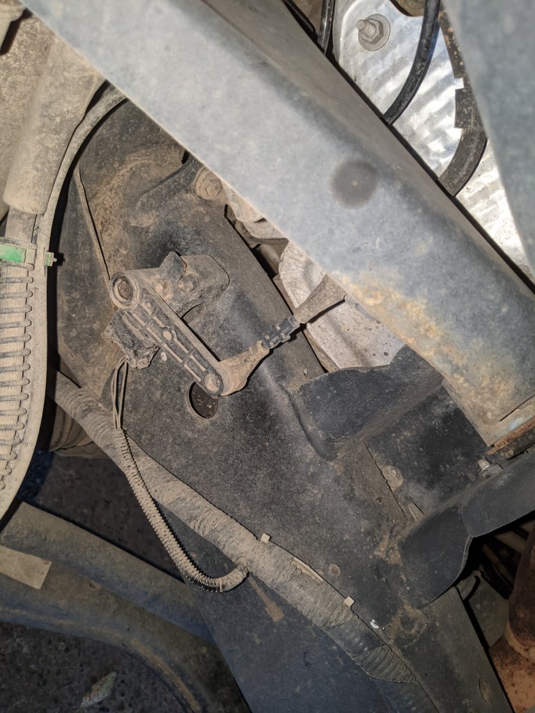

Here's my passenger side, arm also pointing towards the rear:
