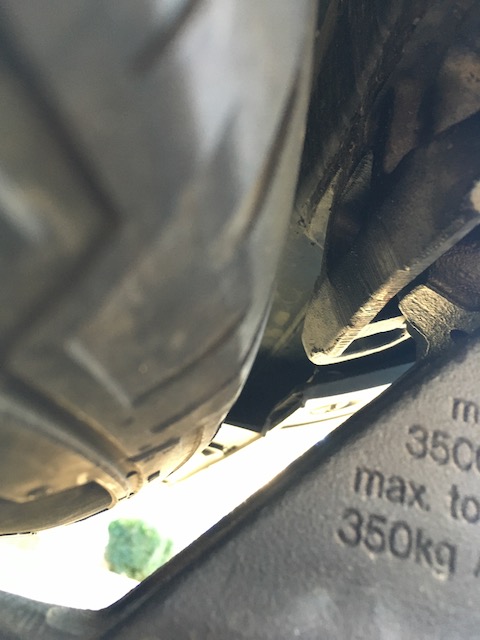

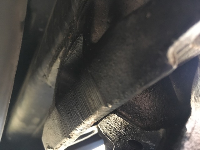

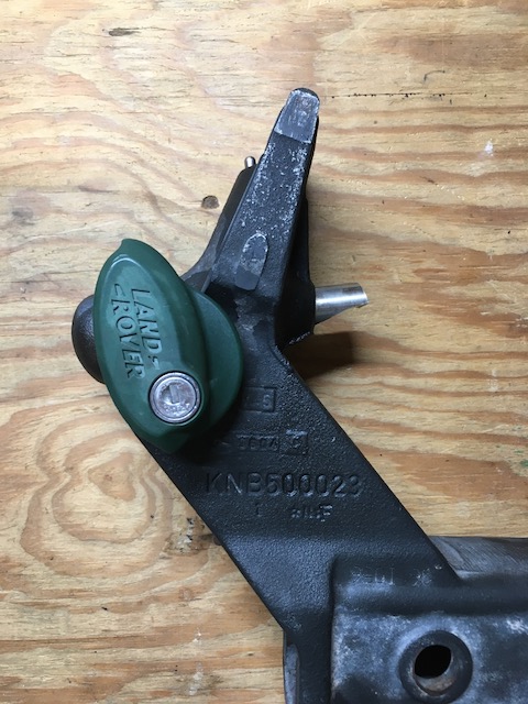

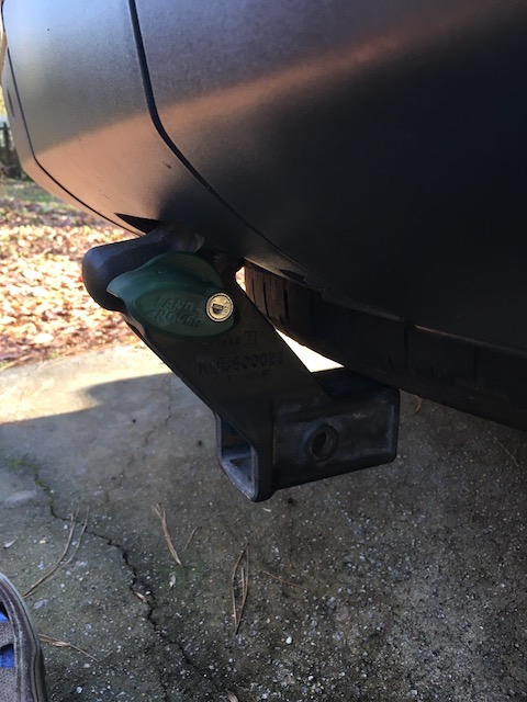

Here is what I'm referring to. Notice in the first picture how far the pin extends and the angle of the green handle. Then in the second two you can't really see the pin protruding through the hole in the mount. Additionally, the green handle is at a different angle than when off the vehicle, hence a different pin extension.

I don't have this hitch. The physics of this design never made sense to me starting with the aspect that you described. It just doesn't seem like a robust way of latching into the receiver. I know that tons of people use this hitch w/o incident but other than that I can't speak from direct experience.
