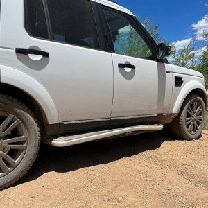

In case you're wondering how those side-steps do...
