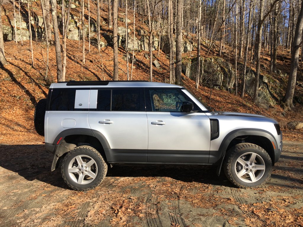

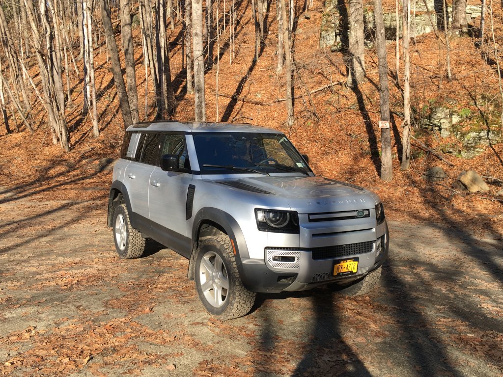

I have an SE with the P400 and 20" wheels. Upgraded and added 1.5" Johnson Rods and put on the 265/60R20 BF Goodrich KO2 tires. These are 32.5" in Diameter and 11" wide, they are basically half an inch larger in both diameter and width. The truck handles fine on highway and is awesome off road. I have a little rubbing on the front classic mudflaps with the wheels turned all the way to the side. It is worse in reverse when turned. I am trimming the side of the interior portion of the mudflap mount a bit...this should stop the rubbing. Also looked at tires that were 33" in diameter and a bit wider...not sure I would do that.....you would have to use say a 2" Proud Rhino Lift and would definitely have to remove the mudflaps. Got the info on the 275 and the Proud Rhino Lift from LR Denver...check out their You tube videos

FWIW, my Nitto Ridge Grappler 255 70 18 are approximately 31.5" tall as installed (50psi) though they theoretically would be 32.1" tall x 10" wide.
They performed great on Imogene Pass as well as on the highway. Tire noise was barely noticeable.
