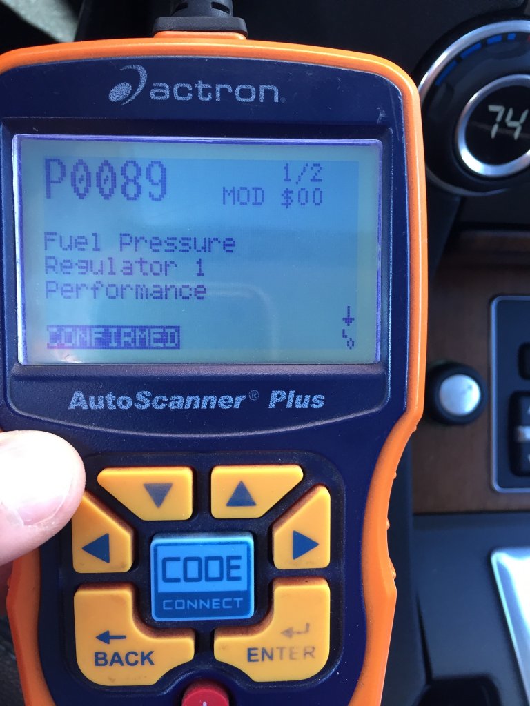

    I just bought a 2015 LR4 with 70k miles, and after driving it for a month the “check engine” light came on. Advanced Auto let me use their scanner and I got the attached output (see images) P0089 Fuel Pressure Regulator.
    Advanced Auto recommended YouTubing it and I didn’t find much. The parts are only $35/pc, but I’m concerned that I might screw something up. I’ve got a long (850 mile one way) drive coming up soon and don’t want to have any problems.

    Sounds like a fuel pump is needed, but I'm no expert. Replaced mine twice which now has 79k miles.

    Ooof. I would really find someone with a good scanner and read fuel pressures in live data before you trek down the fuel pump journey. What part is $35?

    It was a fuel pressure regulator. He noted that there was one per cylinder. Not entirely confident that he knew what he was talking about.

    A code scammer as posted above spitting out a number does not allow live readings in real time while your driving what the fuel rail pressures are which a different scan unit offers.
    Analog or digital gauges with a laptop will show you what is out of spec. A pressure gauge connected to the fuel rail, take the rail return line back to the fuel tank and pinch off a couple seconds allowing a quick check the maximum pressure the fuel pump will generate to eliminate the fuel pump as that problem. One less PITA labor to replace item. Also rail pressures knowing what they are will establish what the pressure regulator is maintaining be it too high or too low as they can and will fail. Sensor failures the last on the list of suspects also an item that might or can fail. It's a Land Rover.
    Note all the above tests costing not a single penny vs throwing expensive parts at it until "fixed". Expensive dealership repairs, labor the clock's ticking including replacement of unneeded parts as "customer pays". They then become the miracle mechanics to the average LR owners, so sad.
