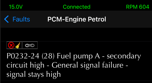

Hi Folks, following my recent Timing Chain endeavor, I'm getting the following code which returns immediately after it's been cleared:
"P0232-24 (28) Fuel pump A - secondary circuit high - General signal failure - signal stays high"
But unlike others, the truck runs absolutely fine, I've not broken down like @MellonRover described here:
In the timing chain thread here:
@Rover Range had me check fuse F1 (25A) which was fine... I'm wondering if I'm running in to electrical issues, perhaps a failing battery? FWIW, I just measured the battery voltage at lunch time and it's very low at 11.8V but the temperature is also 24F (-5C). I have noticed while driving that the rev counter needle back light has been flickering but other than this the car seems completely normal. I see the voltage generally at about 14.7V when it's running. Any thoughts?
Thanks.

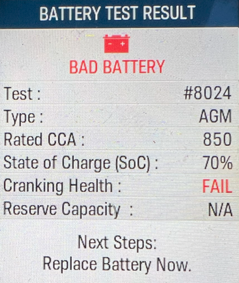

Folks - You are geniuses :).
Battery failed the test at AutoZone (it was dated 10/2019 so not too bad of a run):
A new one is $244.99, based on other reviews I went to Costco and bought an H7 Interstate AGM battery (currently it's $179.99); I installed it this evening and the engine fault is gone :) (Yay). I reset the battery with the Gap tool using this procedure:
Run the routine... Shiny new battery is behaving and comes with a three year warranty. Thanks for the help.
