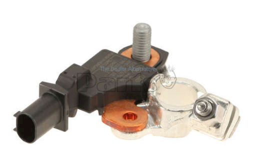

I pulled the plug on the BMS on the negative cable and tested battery voltage. On the battery I had 12.9v and on one of the pins of the BMS I only had 6.64v. Is this normal? It doesn't seem like it is. I found this post (older model and BMS is different).
Mine looks like this and if I put multimeter on the top pin inside the plug is when I read 6.64v.
