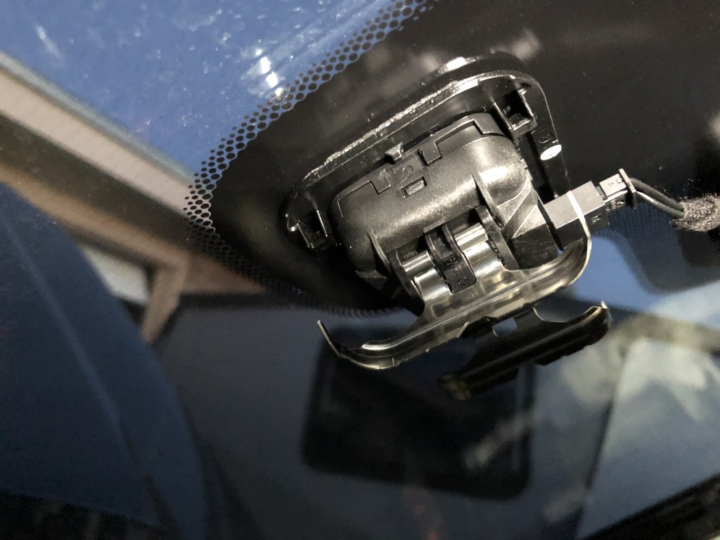

    Any tips on anything I could do to prep the LR before the Safelite guy arrives? I requested someone who has LR experience, but we’ll see. Guess I’ll study the repair manual today. Particularly nervous about the wipers and RV mirror unit.

    It’s going pretty well but I need help with the rain sensor...looks nothing like the manual. Do I lift the plastic part over the gray tab on each side or pry the metal frame it nests in out?
