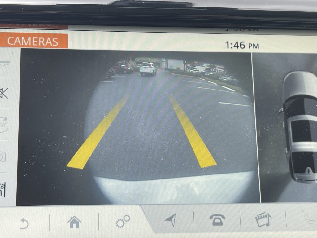

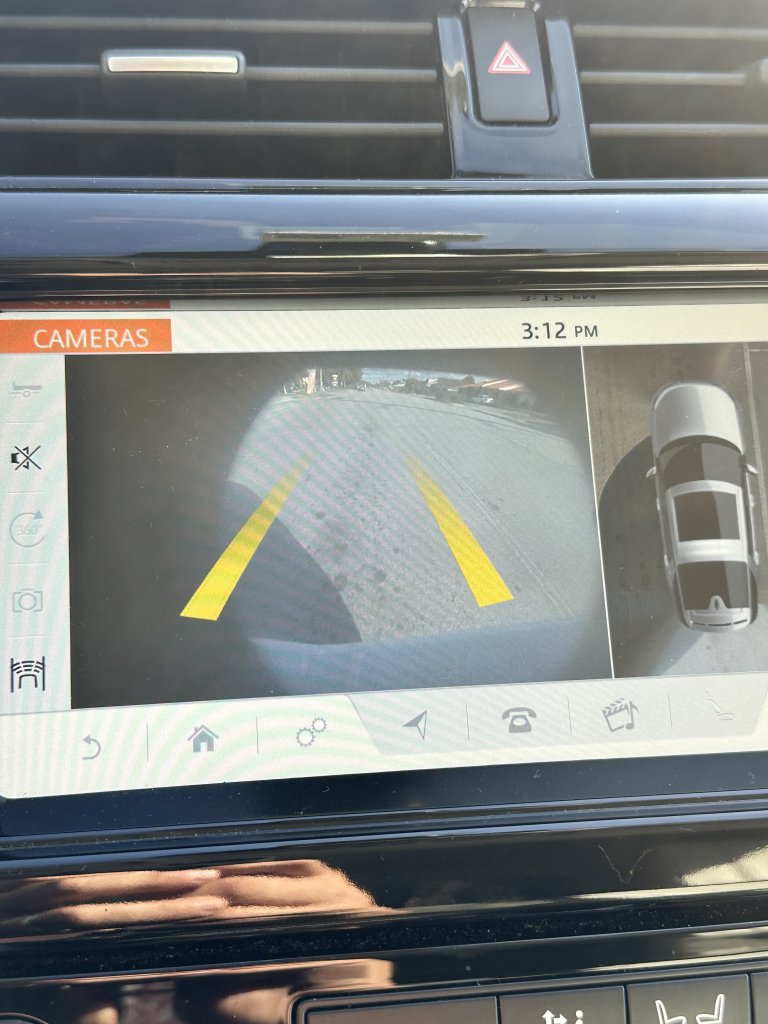

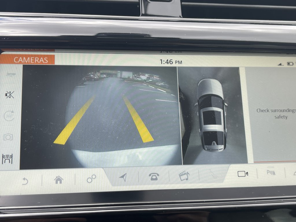

Hello fellow rovers. I assume that while I was washing the rover I must have moved the cameras inside its housing. Not sure what I have to do might have to take apart the rear inside panel and adjust it. There is not that much info on it. If anyone has an idea, sugestión, or even a schematic of how to get to that camera I would greatly appreciate it.
For those that say take it to the dealer there Joe need for that. MASSIVE example: I had my compressor for the suspension go bad, dealer wanted 3k to fix (I’m in Miami where money grows on trees) lol. An amazing mechanic here said to check a valve I did, cost me $20 and followed a guy on YouTube perfect direction BAM! Fix

You may have pushed the camera into the housing.
The horizontal strip that the camera sits in has several nuts that have to be removed.
Remove the rear hatch inner panel to access these nuts. Then the camera panel pops off. See if the camera is adrift.

Update on my back up camera so I did push it in accidentally while cleaning. It snapped out of his little housing. It’s rather simple. You just have to take off the inner tailgate panel. Make sure you disconnect both lights and then you’ll have access to the little camera housing when you take off the real panel, you will be able to takeoff the black trim piece that runs the length of the lights that is above your tack. There you can adjust and clean your camera as well. Anyways, good luck I’ll just help anyone and everyone God bless.
