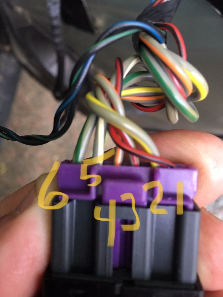

    My rear passenger side window has stopped working.
    Driver side (left, it’s a LHD) is good. I swapped the switches between left and right in the doors as well as in the console.
    When I activate the switch up there is a slight noise in the door by the motor. Very brief. Down position there is nothing. I have also checked the wiring going to the switch and here’s what I found:
    Rear right (defective) has 12v to 2 only
    Rear left (good) has power to 2 and 5
    Console switch has power to 2 and 5
    What do you guys think?[​IMG]

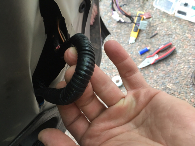

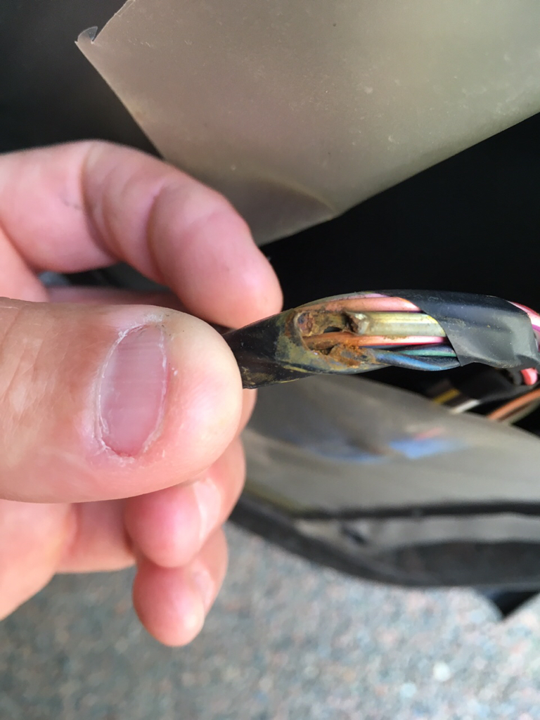

    All fixed. It was the wiring loom having chafed in the door. [​IMG][​IMG]

    Ouch burned wires is never good, I was about to suggest pulling the window ECU and checking the solider joints.
