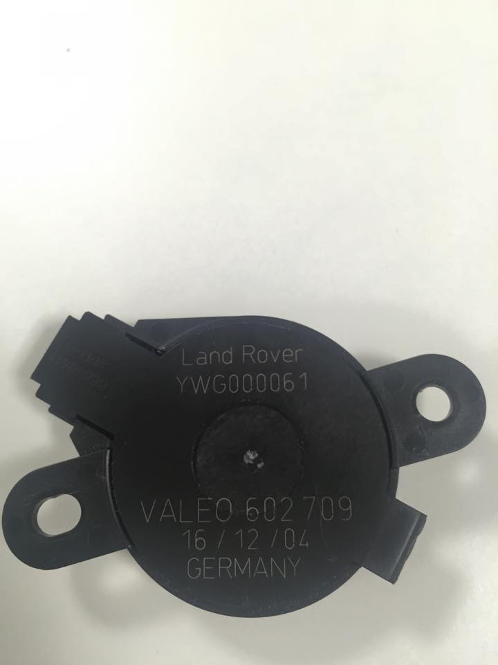

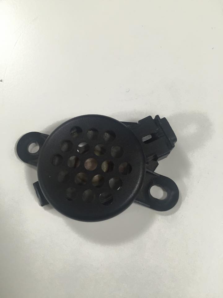

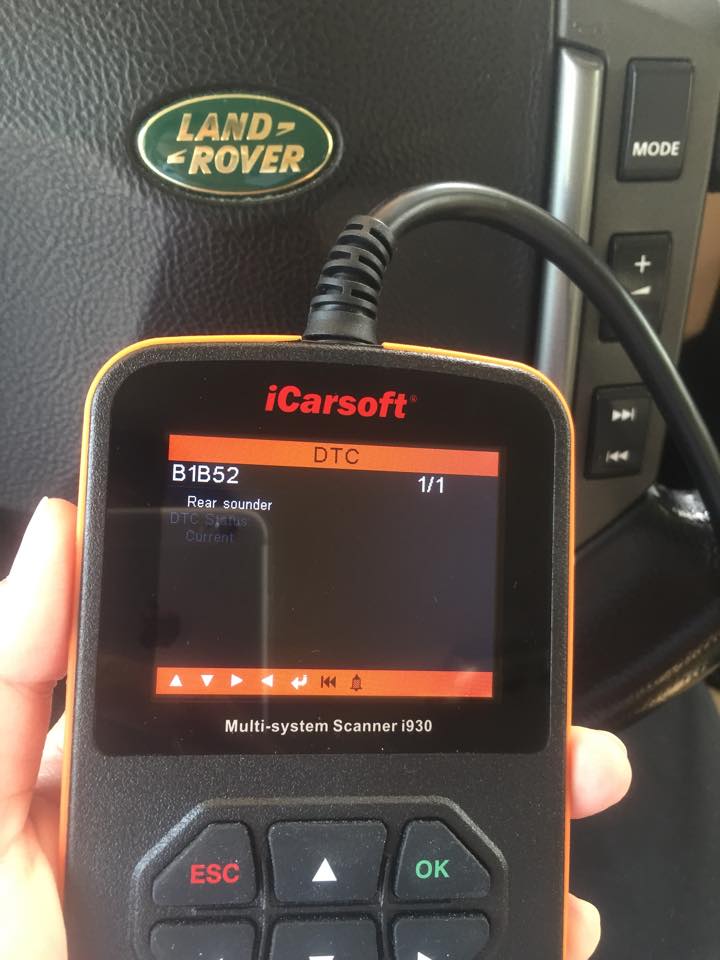

So, I have 2005 LR3 2005 v8 HSE (only rear parking sensor), it's not working.
I check with my tool seems rear sounder only?
I managed to remove the speaker (parking aid sounder) and seems it's the problem, any other ever face similar issue? Just to ensure it's the problem before buying new speaker
pics attached

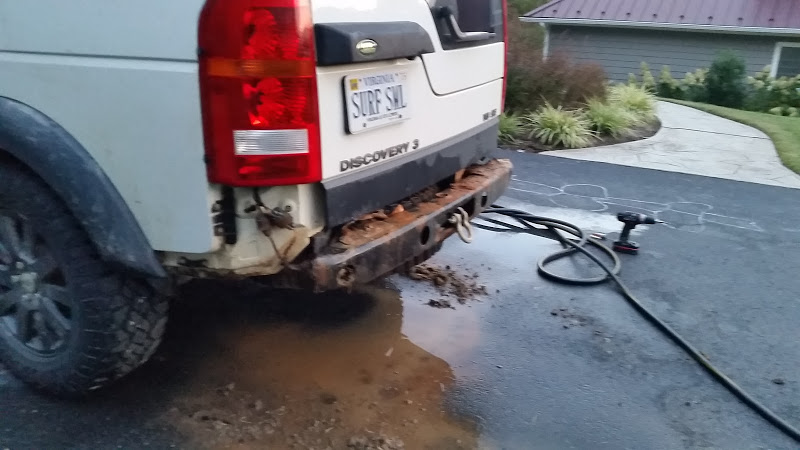

I just placed the wire harness for the sensors last weekend. One of my plugs got damaged when the bumper skin was ripped off. I think I shed 30lbs of mud cleaning out the bumper.

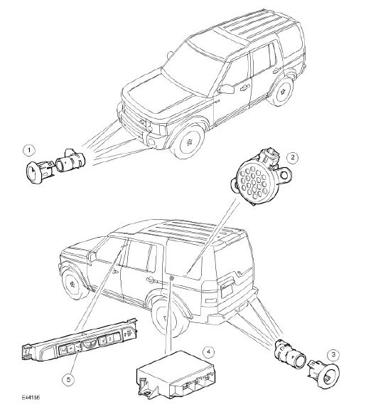

That speaker should be located on the driver's side (for LHD vehicles... assume it's still the left side for others) in the cargo space behind the plastic trim panel. Kind of near the audio out jack and controls for the passengers.
z1234567890
Oct 6, 2014
28
Yes, you are right.

Just to close this topic (sorry for late post), I replaced the rear sounder (a.k.a parking speaker) and now parking sensor function is fine.
Regards
