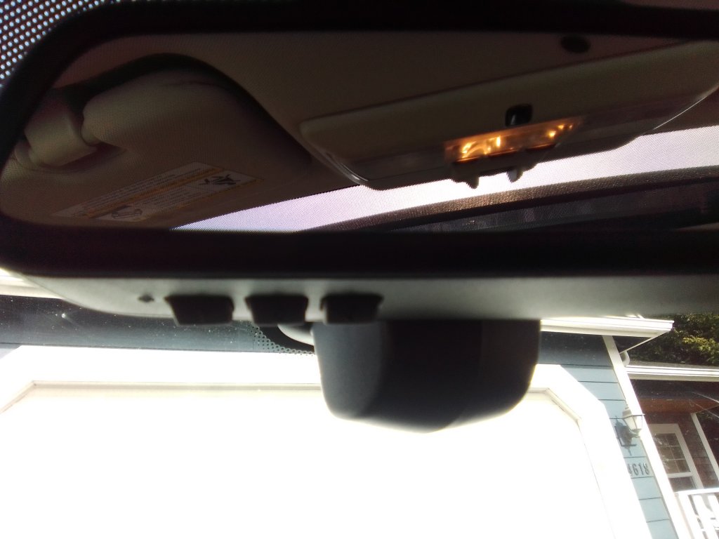

2011 LR4. Noticed there are three soft buttons on the lower left side of the rearview mirror. Looked in the owner's manual and all they talk about are the side mirrors. Tried pushing the buttons and a little LED light came on next to the button as I was holding it down. Went off as soon as I released. Didn't see any other difference in the mirror. Tried all three buttons and got the same result. Does anyone know what these soft buttons are for? Attached is a pic of the underside of the mirror.

Finally got around to getting my LR4's HomeLink (located on the bottom of the rearview mirror) programmed to open my Genie garage door opener. Had been using the clunky plastic clip-on garage door opener clamped onto my sun visor. (Hopefully those impression marks will fade over time).

@txfromwi I had the same problem initially. Where I was going wrong is I just programmed the soft button on the LR4 but never activated the "learn" function on the garage door opener. Apparently some garage doors will sync up just by programming the HomeLink soft key on the vehicle. Mine required activating the learn button to make the wireless connection. I was lucky enough to find the old manual for the garage door opener. The instructions were about three lines and one small diagram showing the learn button and blinking activation light. Once I followed those simple instructions, the HomeLink synced up to my Genie garage door opener immediately.
The HomeLink website is also pretty good for finding the right instructions for your unit.
