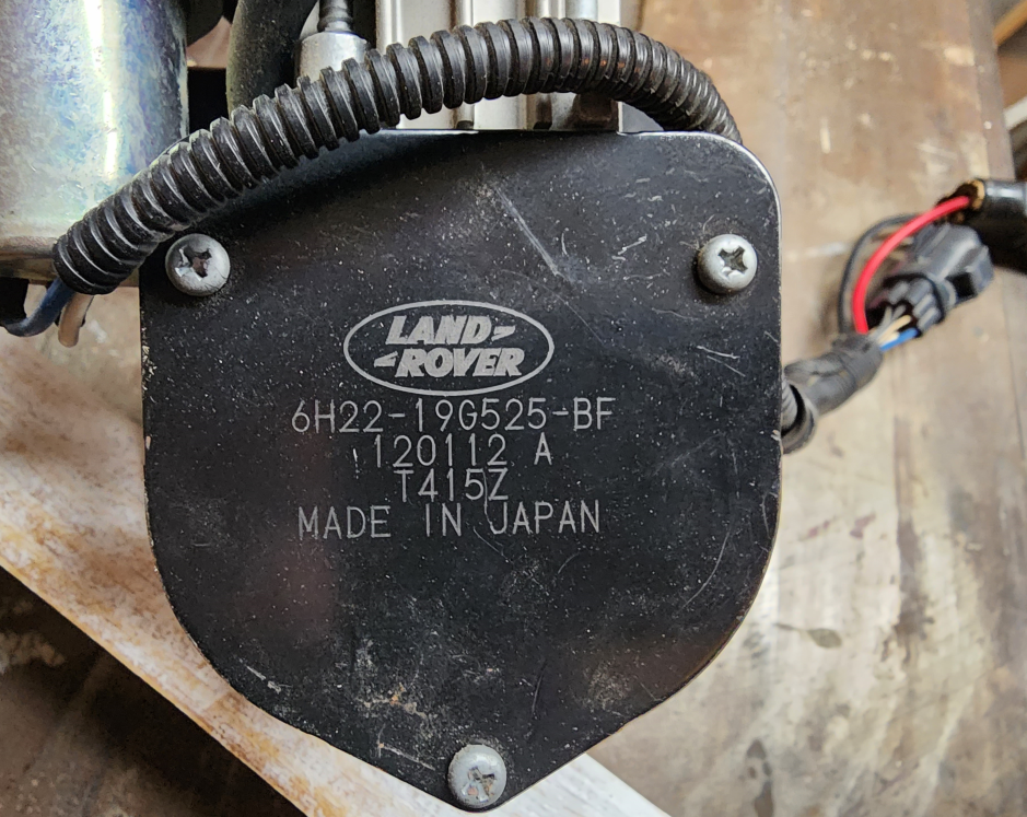

I had a Hitachi and ordered an aftermarket but it was Hitachi brand, I can't remember where from but it was the exact match to the one I took out except it didn't have Landrover on it. I had rebuilt the old one once and am pretty sure I paid like $160 for the aftermarket Hitachi. It's been in for over a year with no issues. Range Rovers . net has an article covering this error code and there was an air leak at the red connector that was the problem after rebuilding the compressor. Try the soap and water spray looking for bubbles and you might find a leak.

Thanks do you have any idea what brand compressor that was? Did it say hitachi in the description? I did the soap and water test found bubbles where the blue and red fittings are so I switched the cover for a new one and now there are no bubbles but the code is still there.

It was a hitachi brand but just didn't have LR on it anywhere. I looked in my email and can't find where I ordered it from but I'm 99% sure it was less than $160. And I actually just threw away the old one but am pretty sure I got the numbers off one of the LR parts places and then googled that.

I thought I threw away the old compressor but didn't, if I recall correctly the replacement I bought was identical but didn't say Landrover on the end cap.
