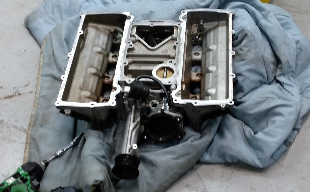

I am currently doing this Job on my 2012 Sport. I have all the bolts off and the supercharger should come off but it is not budging? Has anyone ever have this issue?

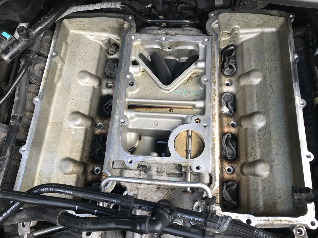

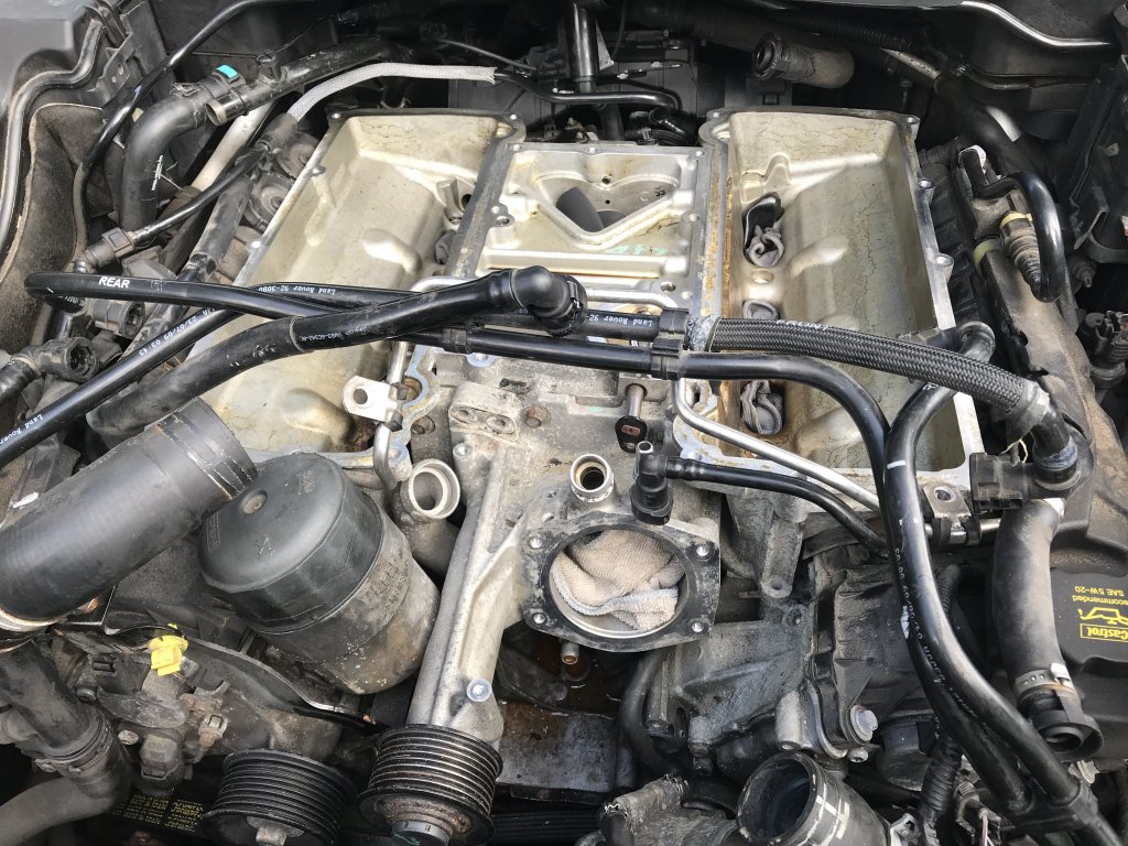

I'm exactly where wchamp is at. I have the top of the supercharger off my 2010 RR 5.0. I've removed the eight 10mm center bolts inside the supercharger, and have even removed two of the top EGR bracket bolts from the back of the supercharger. And still, it does not want to budge. Almost like it's still bolted in. Is it just stuck, or are there any other bolts that need loosening? I've attached a couple of pics of where I'm at. Thanks
